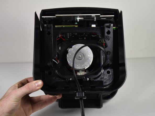

    • Unscrew the four Phillips #2 11mm screws.
    • Remove the plastic covers.
    • Removing the top cover and then rotating the bottom cover into the same orientation works best.

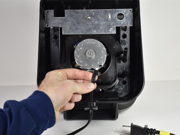

    • Unscrew the three Phillips #2 9mm screws.
    • This metal plate doesn't need to be completely removed, just adjusted to the side to continue working.

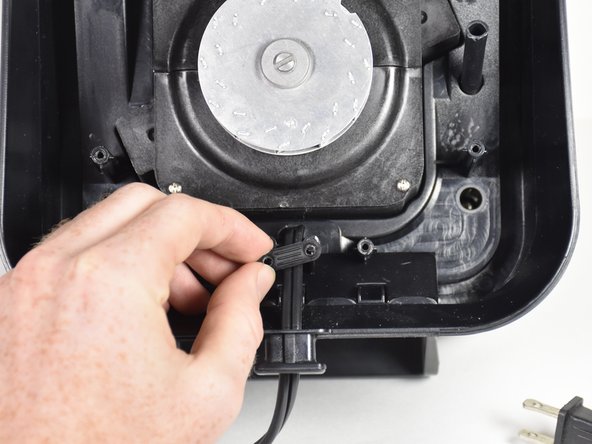

    • Pull the power cord through as shown to create slack.
    • Remove plastic casing by lifting upwards.

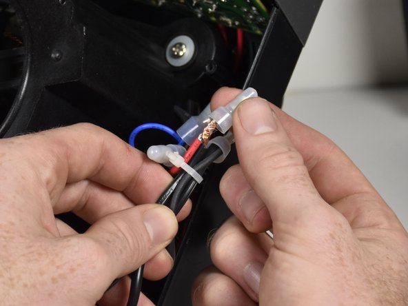

  7. Ninja Ultima BL810 Vent Replacement: crwdns2935265:07crwdnd2935265:01crwdnd2935265:03crwdne2935265:0 Ninja Ultima BL810 Vent Replacement: crwdns2935265:07crwdnd2935265:02crwdnd2935265:03crwdne2935265:0 Ninja Ultima BL810 Vent Replacement: crwdns2935265:07crwdnd2935265:03crwdnd2935265:03crwdne2935265:0

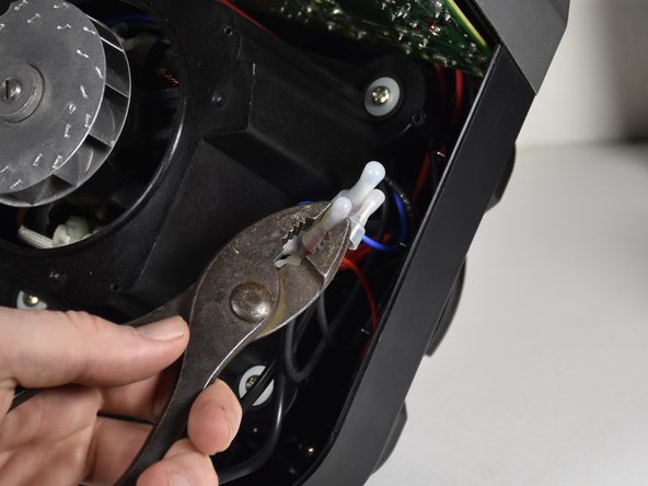

    • Follow the power plug cords to find the right plastic caps.
    • Squeeze the caps with pliers to loosen the grip.
    • Pull the plastic caps off the twisted wires.

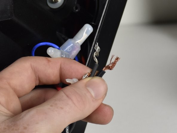

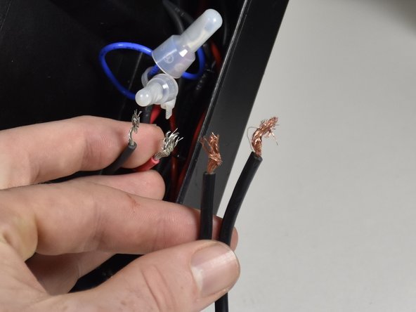

  8. Ninja Ultima BL810 Vent Replacement: crwdns2935265:08crwdnd2935265:01crwdnd2935265:03crwdne2935265:0 Ninja Ultima BL810 Vent Replacement: crwdns2935265:08crwdnd2935265:02crwdnd2935265:03crwdne2935265:0 Ninja Ultima BL810 Vent Replacement: crwdns2935265:08crwdnd2935265:03crwdnd2935265:03crwdne2935265:0
    • Untwist the two wires from each other and pull the zip tie off.

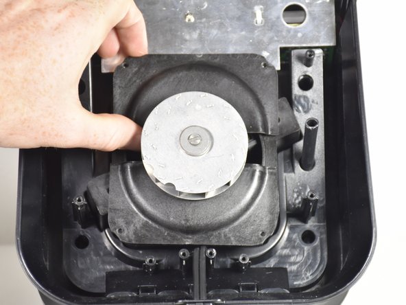

  9. Ninja Ultima BL810 Vent Replacement, Vent: crwdns2935265:09crwdnd2935265:01crwdnd2935265:01crwdne2935265:0

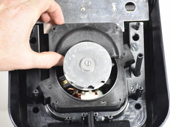

    • Unscrew the 2 Phillips #2 9mm screws.
  10. Ninja Ultima BL810 Vent Replacement: crwdns2935265:010crwdnd2935265:01crwdnd2935265:01crwdne2935265:0
    • Grip the vent on either side and lift it straight in the upward direction.
