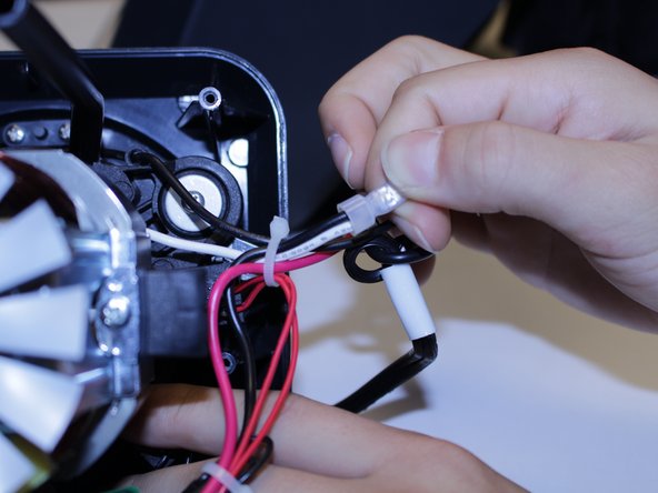

  6. Ninja Professional Blender BL660 Power Cord Replacement, Power Cord: crwdns2935265:06crwdnd2935265:01crwdnd2935265:02crwdne2935265:0 Ninja Professional Blender BL660 Power Cord Replacement, Power Cord: crwdns2935265:06crwdnd2935265:02crwdnd2935265:02crwdne2935265:0
    • Check the connection between the power cord and the wires coming from the circuit board.
  7. Ninja Professional Blender BL660 Power Cord Replacement: crwdns2935265:07crwdnd2935265:01crwdnd2935265:02crwdne2935265:0 Ninja Professional Blender BL660 Power Cord Replacement: crwdns2935265:07crwdnd2935265:02crwdnd2935265:02crwdne2935265:0
    • Remove the plastic caps on the wire connectors with your hands.
    • Ensure that the connections are not loose, corroded, or desoldered.
    • If the connections are desoldered, loose, or corroded, re-solder them using the iFixit soldering guide.
  8. Ninja Professional Blender BL660 Power Cord Replacement: crwdns2935265:08crwdnd2935265:01crwdnd2935265:01crwdne2935265:0
    • If the connections in the preceding step are good, check the connection of the wires to the circuit board.
    • If the connections are loose or damaged, the blender may not be getting power.
  9. Ninja Professional Blender BL660 Power Cord Replacement: crwdns2935265:09crwdnd2935265:01crwdnd2935265:01crwdne2935265:0
    • Re-solder the connections using the iFixit Soldering guide.
    • Make sure you check the correct solder points since the wires are routed differently.
