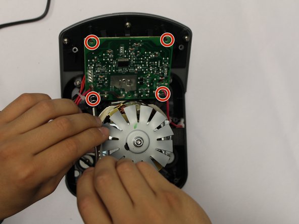

    1. Ninja Professional Blender BL660 Power Button Panel Replacement, Power Button Panel: crwdns2935265:06crwdnd2935265:01crwdnd2935265:03crwdne2935265:0 Ninja Professional Blender BL660 Power Button Panel Replacement, Power Button Panel: crwdns2935265:06crwdnd2935265:02crwdnd2935265:03crwdne2935265:0 Ninja Professional Blender BL660 Power Button Panel Replacement, Power Button Panel: crwdns2935265:06crwdnd2935265:03crwdnd2935265:03crwdne2935265:0
      • Using the Phillips #2 screwdriver, remove the four screws holding the circuit board to the housing.
