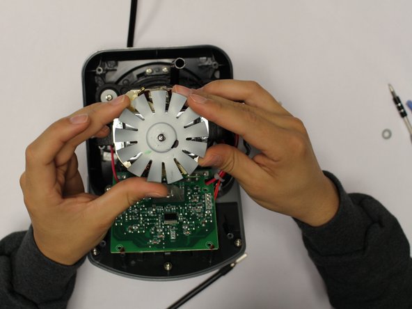

  6. Ninja Professional Blender BL660 Fan Replacement, Fan: crwdns2935265:06crwdnd2935265:01crwdnd2935265:01crwdne2935265:0
    • Use a wrench or a pair of pliers to help remove the nut on top of the fan. Holding the fan itself will help make the process easier.
    • The fan blades are sharp. Handle with care. Using a paper towel or cloth while handling is recommended.
  7. Ninja Professional Blender BL660 Fan Replacement: crwdns2935265:07crwdnd2935265:01crwdnd2935265:01crwdne2935265:0
    • Use the plastic opening tool to loosen the washer.
  8. Ninja Professional Blender BL660 Fan Replacement: crwdns2935265:08crwdnd2935265:01crwdnd2935265:02crwdne2935265:0 Ninja Professional Blender BL660 Fan Replacement: crwdns2935265:08crwdnd2935265:02crwdnd2935265:02crwdne2935265:0
    • Remove washer then slide the fan off the screw.
    • Replace the fan as needed.
    • The fan has a keyed hole, thus it fits on the shaft in a specific way. Ensure you put it on correctly.
