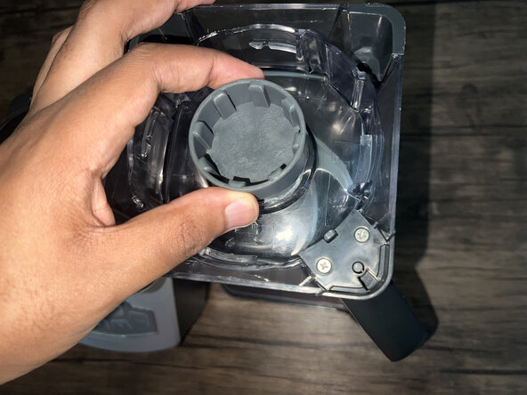

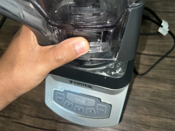

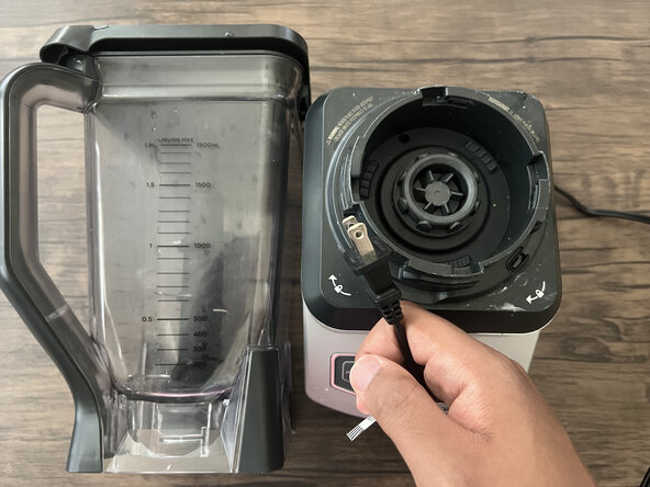

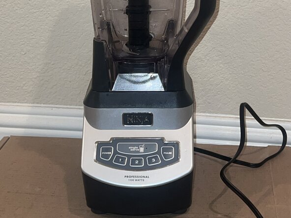

    • Make sure your blender is unplugged before you begin.

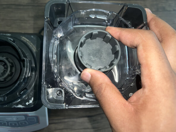

    • Remove the blender jar and blades.
    • Turn the blender jar upside down and set it next to the base.

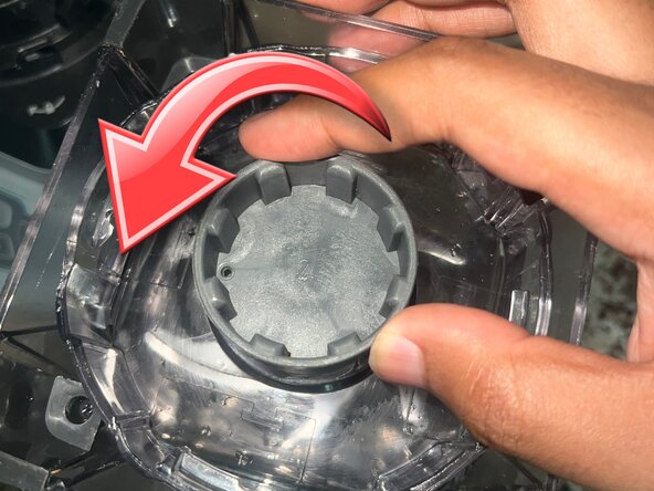

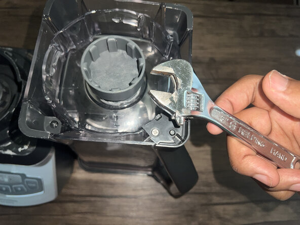

    • Use pliers or a wrench to unscrew the worn drive socket.
    • Make sure to unscrew it counterclockwise.

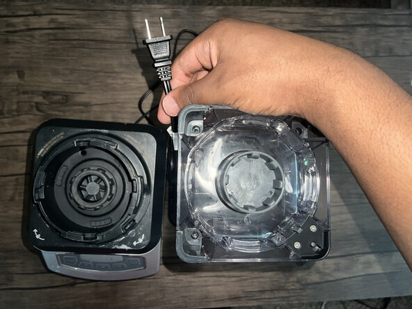

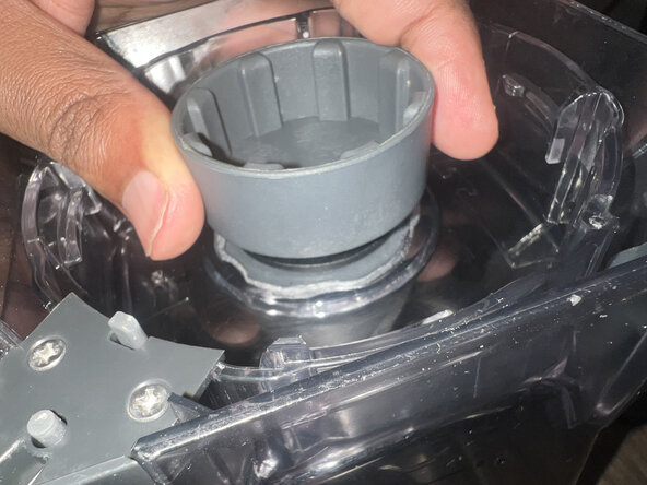

    • Align the replacement drive socket with the mount and hand-tighten.
    • Ensure it is tightened securely.
  4. Ninja Professional Blender BL660 Drive Socket Replacement: crwdns2935265:04crwdnd2935265:01crwdnd2935265:02crwdne2935265:0 Ninja Professional Blender BL660 Drive Socket Replacement: crwdns2935265:04crwdnd2935265:02crwdnd2935265:02crwdne2935265:0

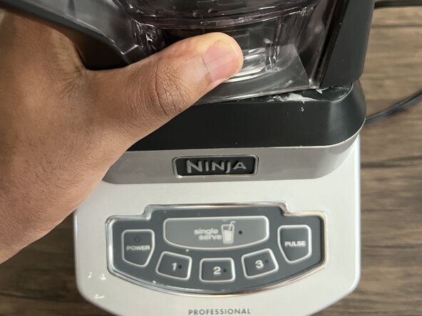

    • Twist the blender jar back into its base.
    • Test the new socket by running the blender with an empty jar.
