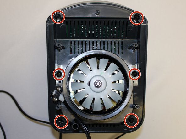

  3. Ninja Professional Blender BL660 Circuit Board Replacement: crwdns2935265:03crwdnd2935265:01crwdnd2935265:02crwdne2935265:0 Ninja Professional Blender BL660 Circuit Board Replacement: crwdns2935265:03crwdnd2935265:02crwdnd2935265:02crwdne2935265:0
    • Using the Phillips #1 screwdriver, remove the 6 screws (13 mm long, 6 mm wide).

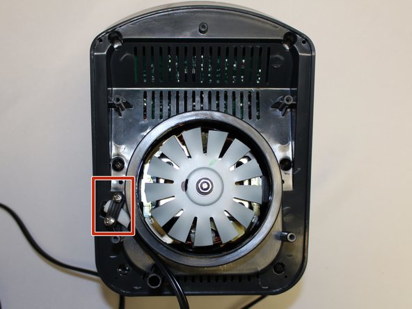

  4. Ninja Professional Blender BL660 Circuit Board Replacement: crwdns2935265:04crwdnd2935265:01crwdnd2935265:02crwdne2935265:0 Ninja Professional Blender BL660 Circuit Board Replacement: crwdns2935265:04crwdnd2935265:02crwdnd2935265:02crwdne2935265:0
    • Using the Phillips #1 screwdriver, remove the two screws (5 mm long, 3 mm wide) holding the power cord onto the motor cover.

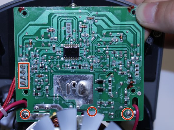

  6. Ninja Professional Blender BL660 Circuit Board Replacement, Circuit Board: crwdns2935265:06crwdnd2935265:01crwdnd2935265:02crwdne2935265:0 Ninja Professional Blender BL660 Circuit Board Replacement, Circuit Board: crwdns2935265:06crwdnd2935265:02crwdnd2935265:02crwdne2935265:0
    • Using the Phillips #2 screwdriver remove the 4 screws (10mm long, 5mm wide) on the circuit board.

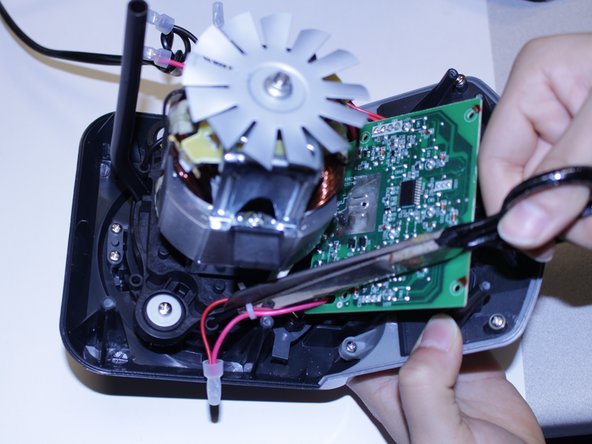

  7. Ninja Professional Blender BL660 Circuit Board Replacement: crwdns2935265:07crwdnd2935265:01crwdnd2935265:02crwdne2935265:0 Ninja Professional Blender BL660 Circuit Board Replacement: crwdns2935265:07crwdnd2935265:02crwdnd2935265:02crwdne2935265:0
    • To give the circuit board further range of motion, remove the pictured zip ties holding the cables.
  8. Ninja Professional Blender BL660 Circuit Board Replacement: crwdns2935265:08crwdnd2935265:01crwdnd2935265:02crwdne2935265:0 Ninja Professional Blender BL660 Circuit Board Replacement: crwdns2935265:08crwdnd2935265:02crwdnd2935265:02crwdne2935265:0
    • Desolder the seven wires indicated from the circuit board.
    • For further instruction on sodering and desodering reference iFixit's guide.
    • To ensure the sodering of the correct wires, make sure to flip the circuit board over and confirm the wires that are being altered.
    • Soldering iron is hot. Handle with care.
  9. Ninja Professional Blender BL660 Circuit Board Replacement: crwdns2935265:09crwdnd2935265:01crwdnd2935265:01crwdne2935265:0
    • Once the wires are cool to the touch, remove circuit board.
    • Remember to keep track of all cables removed to ensure their correct placement into the new circuit board.
