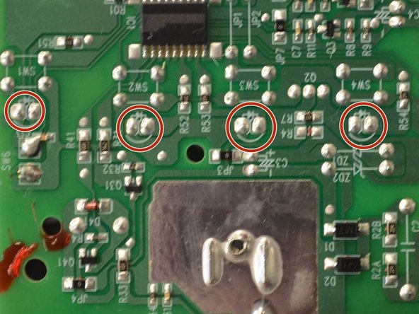

  4. Ninja NJ600 LED Light Replacement, Circuit Board: crwdns2935265:04crwdnd2935265:01crwdnd2935265:01crwdne2935265:0
    • Remove these four screws (10mm long, 5mm head diameter) using a Phillips #2 screwdriver.
    • Be careful not to scratch the circuit board with the screwdriver.

  6. Ninja NJ600 LED Light Replacement: crwdns2935265:06crwdnd2935265:01crwdnd2935265:03crwdne2935265:0 Ninja NJ600 LED Light Replacement: crwdns2935265:06crwdnd2935265:02crwdnd2935265:03crwdne2935265:0 Ninja NJ600 LED Light Replacement: crwdns2935265:06crwdnd2935265:03crwdnd2935265:03crwdne2935265:0
    • Desolder the five wires from the solder pads shown.
    • If you do not know how to do this, iFixit has a guide describing the process.
    • Before you begin to desolder these wires, flip the board over to confirm that you are about to desolder the correct component.
    • Soldering iron is very hot, use caution when handling
  7. Ninja NJ600 LED Light Replacement: crwdns2935265:07crwdnd2935265:01crwdnd2935265:01crwdne2935265:0
    • After the wires have cooled enough to touch, carefully slide the circuit board free of the wires.
    • NOTE: keep track of which pad each wire was soldered to. This is important for your blender to function.
  8. Ninja NJ600 LED Light Replacement, LED Light: crwdns2935265:08crwdnd2935265:01crwdnd2935265:02crwdne2935265:0 Ninja NJ600 LED Light Replacement, LED Light: crwdns2935265:08crwdnd2935265:02crwdnd2935265:02crwdne2935265:0
    • Locate the LED you wish to desolder.
    • On the bottom of the board, each LED is designated with a small triangle with a line at one tip.
  9. Ninja NJ600 LED Light Replacement: crwdns2935265:09crwdnd2935265:01crwdnd2935265:01crwdne2935265:0
    • Desolder the two LED leads, and remove the LED from the board.
    • NOTE: the LED is a diode, and requires proper orientation when installed.
