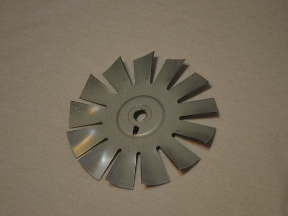

  4. Ninja NJ600 Fan Replacement, Fan: crwdns2935265:04crwdnd2935265:01crwdnd2935265:01crwdne2935265:0
    • Hold the fan steady and use a wrench or pliers to remove the nut in the image.
    • The fan is sharp. Use caution when handling with bare hands.
    • A towel or gloves may be useful when holding the fan for this step.
  5. Ninja NJ600 Fan Replacement: crwdns2935265:05crwdnd2935265:01crwdnd2935265:01crwdne2935265:0
    • Hold the fan and use the flathead 4.0 screwdriver to loosen the washer.
    • The fan is sharp, use caution when handling with bare hands.
    • You may use a towel or gloves to avoid handling the fan with your bare hands.
  6. Ninja NJ600 Fan Replacement: crwdns2935265:06crwdnd2935265:01crwdnd2935265:02crwdne2935265:0 Ninja NJ600 Fan Replacement: crwdns2935265:06crwdnd2935265:02crwdnd2935265:02crwdne2935265:0
    • Slide the washer and fan off of the screw.
