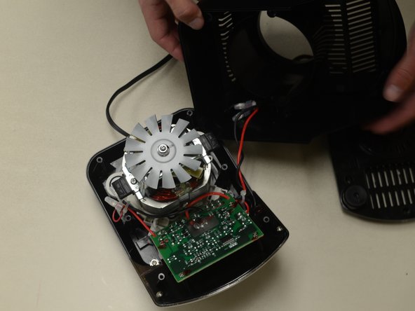

  3. Ninja NJ600 Button Replacement: crwdns2935265:03crwdnd2935265:01crwdnd2935265:03crwdne2935265:0 Ninja NJ600 Button Replacement: crwdns2935265:03crwdnd2935265:02crwdnd2935265:03crwdne2935265:0 Ninja NJ600 Button Replacement: crwdns2935265:03crwdnd2935265:03crwdnd2935265:03crwdne2935265:0
    • Using the Phillips #2 screwdriver, remove these six screws (13mm long, 6mm head diameter). Then carefully remove this layer, and rest it next to the blender base.
    • Be careful not to damage the two wires that are keeping this third layer attached to the base.

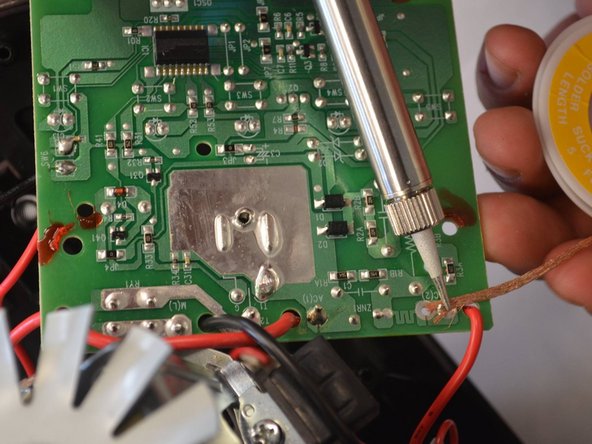

  6. Ninja NJ600 Button Replacement: crwdns2935265:06crwdnd2935265:01crwdnd2935265:03crwdne2935265:0 Ninja NJ600 Button Replacement: crwdns2935265:06crwdnd2935265:02crwdnd2935265:03crwdne2935265:0 Ninja NJ600 Button Replacement: crwdns2935265:06crwdnd2935265:03crwdnd2935265:03crwdne2935265:0
    • Desolder the five wires from the solder pads shown.
    • If you do not know how to do this, iFixit has a guide describing the process.
    • Before you begin to desolder these wires, flip the board over to confirm that you are about to desolder the correct component.
    • Soldering iron is very hot, use caution when handling
  7. Ninja NJ600 Button Replacement: crwdns2935265:07crwdnd2935265:01crwdnd2935265:01crwdne2935265:0
    • After the wires have cooled enough to touch, carefully slide the circuit board free of the wires.
    • NOTE: keep track of which pad each wire was soldered to. This is important for your blender to function.

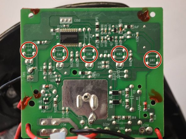

  8. Ninja NJ600 Button Replacement, Button: crwdns2935265:08crwdnd2935265:01crwdnd2935265:02crwdne2935265:0 Ninja NJ600 Button Replacement, Button: crwdns2935265:08crwdnd2935265:02crwdnd2935265:02crwdne2935265:0
    • After removing the circuit board from your device, locate which button you wish to replace.
    • On the opposite side of the circuit board from the button, there are four solder pads with the designation "SW" followed by a number.
  9. Ninja NJ600 Button Replacement: crwdns2935265:09crwdnd2935265:01crwdnd2935265:01crwdne2935265:0
    • Desolder these four solder pads.
    • These pads are small, so take care to not damage the circuit board.
    • NOTE: the orientation of the buttons is important. Make sure you place the new button in the correct orientation.
