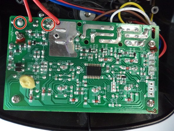

      • Remove 4 screws (11mm, 4mm head) connecting the circuit board to the base.
    1. Ninja Mega Kitchen System BL770 Power Cord Replacement, Power Cord: crwdns2935265:05crwdnd2935265:01crwdnd2935265:02crwdne2935265:0 Ninja Mega Kitchen System BL770 Power Cord Replacement, Power Cord: crwdns2935265:05crwdnd2935265:02crwdnd2935265:02crwdne2935265:0
      • Check that the two red wires shown in the photos are properly soldered to the circuit board.
      • If they seem damaged, resolder the wires to the board.
      • If this doesn't solve the issue, proceed to step 6.
    2. Ninja Mega Kitchen System BL770 Power Cord Replacement: crwdns2935265:06crwdnd2935265:01crwdnd2935265:01crwdne2935265:0
      • If the 2 wires in the previous step are connected, it's time to check the 2nd area.
      • Remove the plastic covers and check that the wires are soldered correctly.
