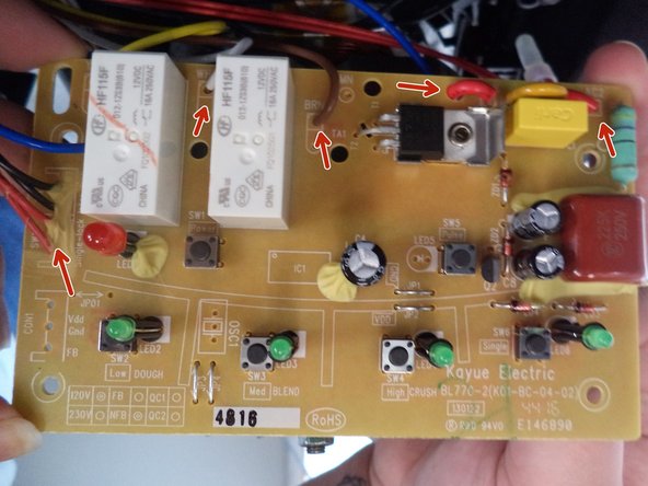

  4. Ninja Mega Kitchen System BL770 Circuit Board Replacement: crwdns2935265:04crwdnd2935265:01crwdnd2935265:01crwdne2935265:0
    • Remove 4 screws (11mm, 4mm head) connecting the circuit board to the base.

  5. Ninja Mega Kitchen System BL770 Circuit Board Replacement, Circuit Board: crwdns2935265:05crwdnd2935265:01crwdnd2935265:02crwdne2935265:0 Ninja Mega Kitchen System BL770 Circuit Board Replacement, Circuit Board: crwdns2935265:05crwdnd2935265:02crwdnd2935265:02crwdne2935265:0
    • Cautiously desolder all the wires connecting the circuit board to the unit.
    • Carefully slide the circuit board free of the wires are place the new board in.
    • Solder the wires back onto the new board, keeping track of which wire goes where in order for your unit to properly function.
