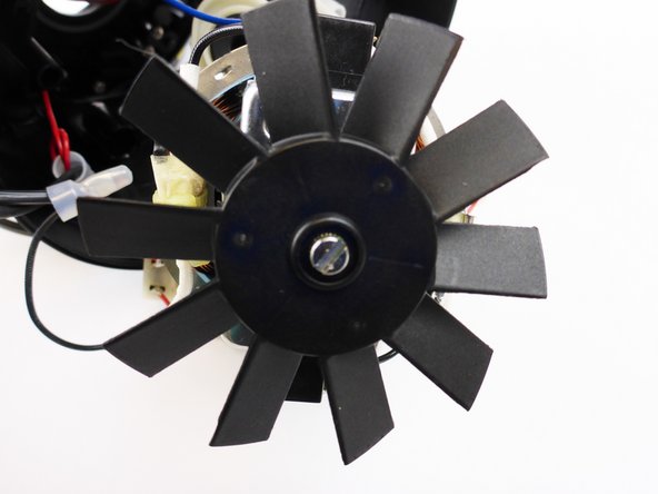

  3. Ninja Kitchen System Pulse Fan Replacement, Fan: crwdns2935265:03crwdnd2935265:01crwdnd2935265:01crwdne2935265:0
    • Remove the central 15 mm length screw, you must hold the fan in place and use a flat head screw driver, twisting counterclockwise.
    • Place this screw on the magnetic mat.
  4. Ninja Kitchen System Pulse Fan Replacement: crwdns2935265:04crwdnd2935265:01crwdnd2935265:02crwdne2935265:0 Ninja Kitchen System Pulse Fan Replacement: crwdns2935265:04crwdnd2935265:02crwdnd2935265:02crwdne2935265:0
    • Remove the fan from the motor by gently pulling upwards.
    • Be careful as to not damage any wires when removing the fan.
    • Set the fan to the side.
