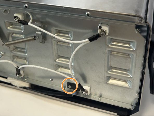

  7. Ninja Foodi SP101 Temperature Sensor Replacement, Temperature Sensor: crwdns2935265:07crwdnd2935265:01crwdnd2935265:02crwdne2935265:0 Ninja Foodi SP101 Temperature Sensor Replacement, Temperature Sensor: crwdns2935265:07crwdnd2935265:02crwdnd2935265:02crwdne2935265:0
    • The temperature sensor is found under the handle side panel.
    • The sensor is held down by a rivet. Here is a guide to removing rivets.
