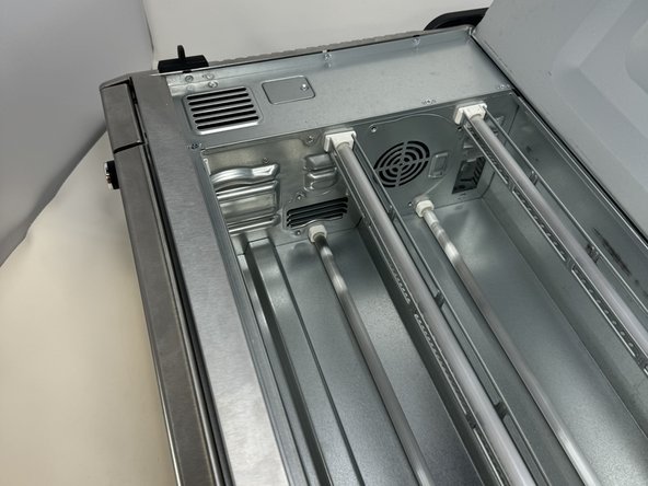

    • Flip the device upside down and open the bottom panel.
    • Remove the 3 x philips #1 screws along the top edge of the interior using a screwdriver. The Bottom 2 do not have to be removed.

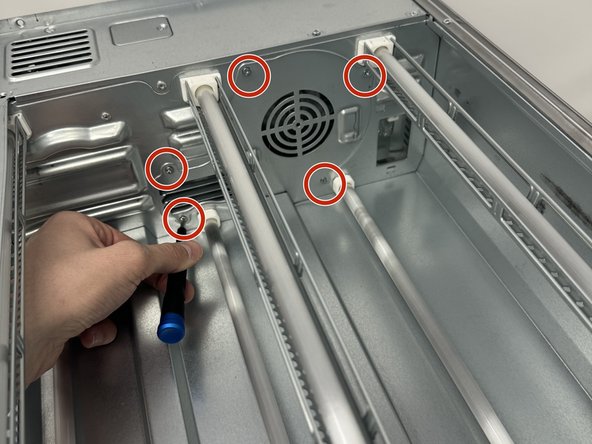

    • Open the bottom door.
    • Remove the five 8 mm screws located on the control panel side using a Phillips #1 screwdriver.
  8. Ninja Foodi SP101 Motor Replacement: crwdns2935265:08crwdnd2935265:01crwdnd2935265:01crwdne2935265:0
    • Remove the four 1 mm screws with a Phillips #1 screwdriver.
    • Remove the motor from the device.
