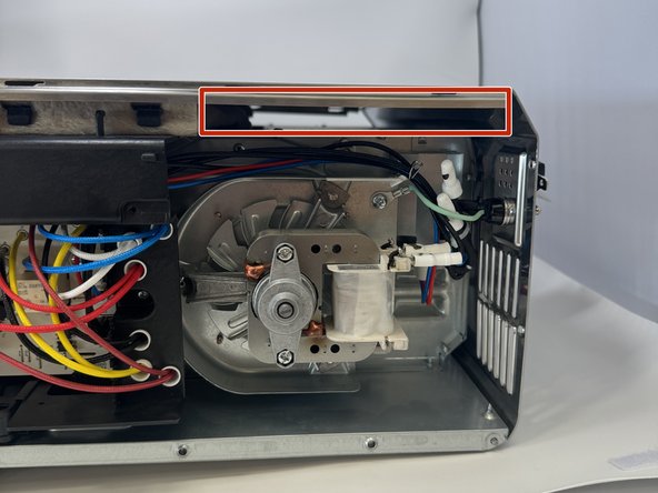

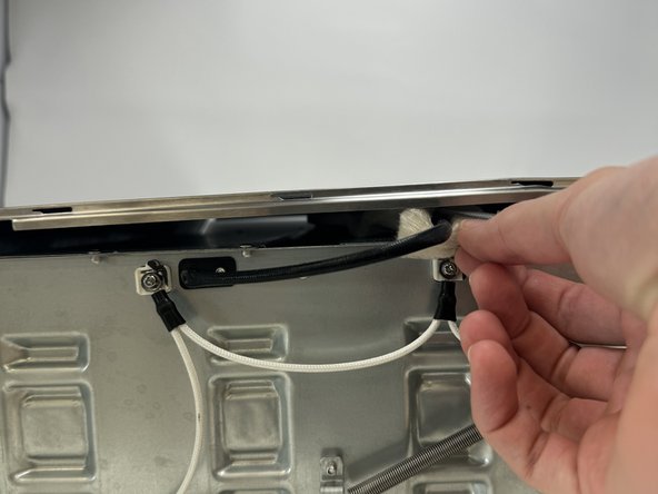

  7. Ninja Foodi SP101 Insulation Replacement, Insulation: crwdns2935265:07crwdnd2935265:01crwdnd2935265:03crwdne2935265:0 Ninja Foodi SP101 Insulation Replacement, Insulation: crwdns2935265:07crwdnd2935265:02crwdnd2935265:03crwdne2935265:0 Ninja Foodi SP101 Insulation Replacement, Insulation: crwdns2935265:07crwdnd2935265:03crwdnd2935265:03crwdne2935265:0
    • Remove the thin piece of insulation from either side.
    • The insulation is made of fiber-glass material. Use gloves when handling.
