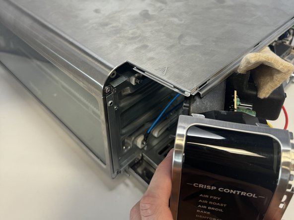

    • Remove the control side panel. To remove it, push forward towards then front control panel to release the tabs out of the main body. Fold away the side panel when the tabs have visually released from their slots in the main body.
  6. Ninja Foodi SP101 Heating Coils Replacement: crwdns2935265:06crwdnd2935265:01crwdnd2935265:02crwdne2935265:0 Ninja Foodi SP101 Heating Coils Replacement: crwdns2935265:06crwdnd2935265:02crwdnd2935265:02crwdne2935265:0
    • Lift the handle and pull the side panel out.
    • Remove the handle side panel.

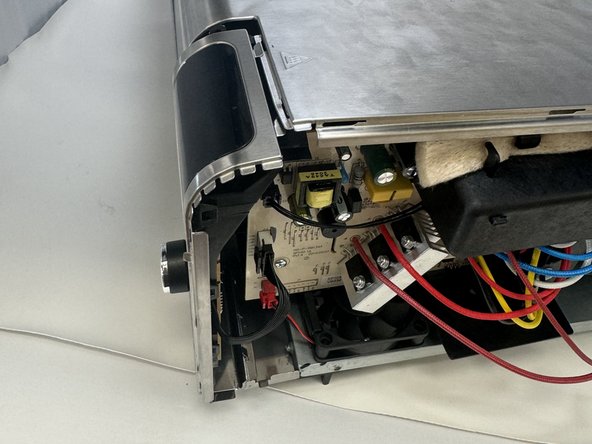

    • Flip the device to the control panel side.
    • Remove the single 10 mm screw with a Phillips #1 screwdriver.
    • Remove the control panel by sliding it up and out.

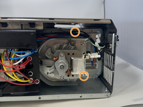

  9. Ninja Foodi SP101 Heating Coils Replacement: crwdns2935265:09crwdnd2935265:01crwdnd2935265:02crwdne2935265:0 Ninja Foodi SP101 Heating Coils Replacement: crwdns2935265:09crwdnd2935265:02crwdnd2935265:02crwdne2935265:0
    • Remove the four 8 mm screws behind the control panel using a Phillips #1 screwdriver.
    • Remove two more screws located behind the motor.
    • You do not need to remove the motor.
