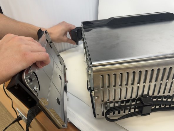

  3. Ninja Foodi SP101 Control Panel Replacement, Side Panels: crwdns2935265:03crwdnd2935265:01crwdnd2935265:01crwdne2935265:0
    • Use a Phillips #1 screwdriver to remove the three 8mm screws on each side of the back panel.

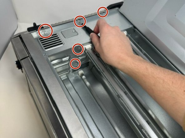

  4. Ninja Foodi SP101 Control Panel Replacement: crwdns2935265:04crwdnd2935265:01crwdnd2935265:02crwdne2935265:0 Ninja Foodi SP101 Control Panel Replacement: crwdns2935265:04crwdnd2935265:02crwdnd2935265:02crwdne2935265:0
    • Flip the device upside down and open the bottom panel.
    • Remove the 3 x philips #1 screws along the top edge of the interior using a screwdriver. The Bottom 2 do not have to be removed.

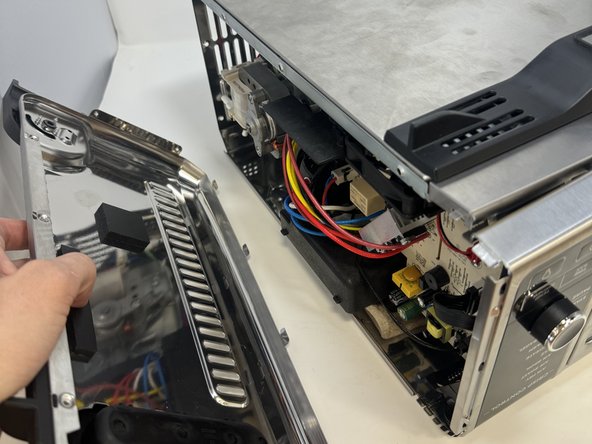

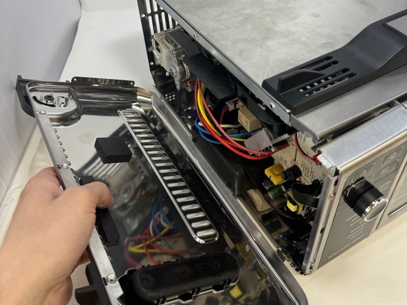

  5. Ninja Foodi SP101 Control Panel Replacement: crwdns2935265:05crwdnd2935265:01crwdnd2935265:03crwdne2935265:0 Ninja Foodi SP101 Control Panel Replacement: crwdns2935265:05crwdnd2935265:02crwdnd2935265:03crwdne2935265:0 Ninja Foodi SP101 Control Panel Replacement: crwdns2935265:05crwdnd2935265:03crwdnd2935265:03crwdne2935265:0
    • Remove the control side panel. To remove it, push forward towards then front control panel to release the tabs out of the main body. Fold away the side panel when the tabs have visually released from their slots in the main body.
  6. Ninja Foodi SP101 Control Panel Replacement: crwdns2935265:06crwdnd2935265:01crwdnd2935265:02crwdne2935265:0 Ninja Foodi SP101 Control Panel Replacement: crwdns2935265:06crwdnd2935265:02crwdnd2935265:02crwdne2935265:0
    • Lift the handle and pull the side panel out.
    • Remove the handle side panel.

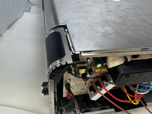

  7. Ninja Foodi SP101 Control Panel Replacement, Control Panel: crwdns2935265:07crwdnd2935265:01crwdnd2935265:01crwdne2935265:0
    • Remove the 10mm screw using the Phillips #1 screwdriver.
    • This screw connects the motherboard to the motor.

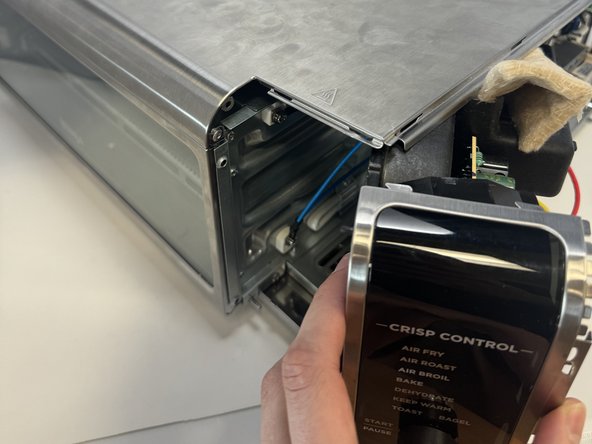

  8. Ninja Foodi SP101 Control Panel Replacement: crwdns2935265:08crwdnd2935265:01crwdnd2935265:03crwdne2935265:0 Ninja Foodi SP101 Control Panel Replacement: crwdns2935265:08crwdnd2935265:02crwdnd2935265:03crwdne2935265:0 Ninja Foodi SP101 Control Panel Replacement: crwdns2935265:08crwdnd2935265:03crwdnd2935265:03crwdne2935265:0
    • Locate the control panel.
    • Slide the top panel outwards and to the right.

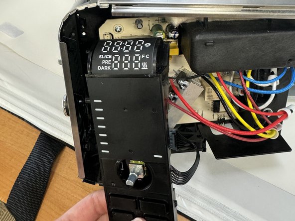

  10. Ninja Foodi SP101 Control Panel Replacement: crwdns2935265:010crwdnd2935265:01crwdnd2935265:02crwdne2935265:0 Ninja Foodi SP101 Control Panel Replacement: crwdns2935265:010crwdnd2935265:02crwdnd2935265:02crwdne2935265:0
    • Unclip the wires from the motherboard.
  11. Ninja Foodi SP101 Control Panel Replacement: crwdns2935265:011crwdnd2935265:01crwdnd2935265:01crwdne2935265:0
    • Remove the control panel.
