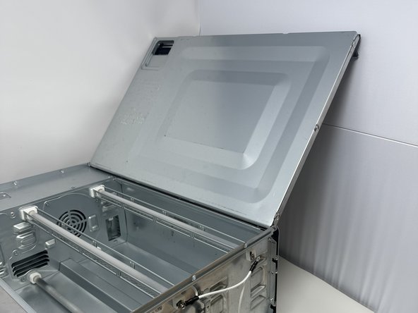

    • Flip the device upside down and open the bottom panel.
    • Remove the 3 x philips #1 screws along the top edge of the interior using a screwdriver. The Bottom 2 do not have to be removed.

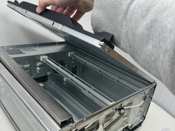

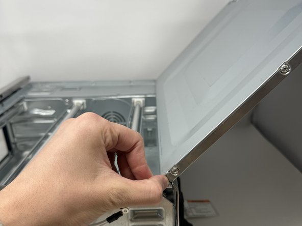

    • Open the bottom panel, and face the handle side of the oven.
  8. Ninja Foodi SP101 Bottom Panel Replacement: crwdns2935265:08crwdnd2935265:01crwdnd2935265:02crwdne2935265:0 Ninja Foodi SP101 Bottom Panel Replacement: crwdns2935265:08crwdnd2935265:02crwdnd2935265:02crwdne2935265:0

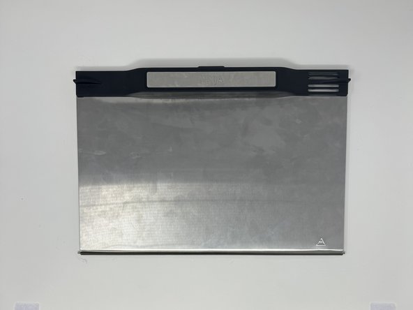

    • Press the pin holding in the door inwards, allowing the door to come free.
  9. Ninja Foodi SP101 Bottom Panel Replacement: crwdns2935265:09crwdnd2935265:01crwdnd2935265:02crwdne2935265:0 Ninja Foodi SP101 Bottom Panel Replacement: crwdns2935265:09crwdnd2935265:02crwdnd2935265:02crwdne2935265:0
    • Remove the door completely by lifting the pin out of the other side.
