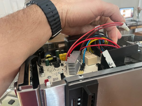

    • Remove the screw from the electronics assembly plastic frame as shown. Don't drop the screw upon removal!
    • Lift the assembly slightly such that the screw to the metal tab that holds the fan in place can be accessed. Remove it with a Philips screw driver. Do not drop it. Use help holding up the assembly if so needed. Do not bend the tab.

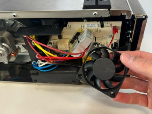

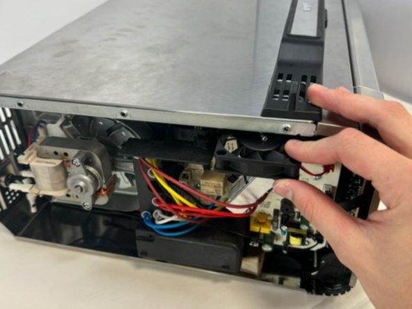

    • Remove the black cooling fan by sliding it out. There are retaining tabs on the sides that need to be lifted to release the fan.
  9. Ninja Foodi SP101 / FT102A Cooling Fan Replacement, Disconnect Old Fan: crwdns2935265:09crwdnd2935265:01crwdnd2935265:01crwdne2935265:0
    • Remove the red cable that attaches the cooling fan to the motherboard. Squeeze the tab on the red connector and pull slightly at the same time to release it.

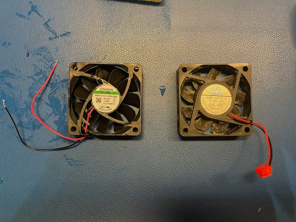

    • Remove the cooling fan and replace it with a new fan of equal size and type: 60 x 60 x 15 mm, 12V DC. Carefully compare for fitment.
    • When the fan comes without a connector or the wrong connector, cut the connector off the old fan, leaving enough wire-length on the connector side of the harness. Strip the ends with a stripping tool or the like.
    • Solder the wires together and apply appropriate insulation. Red to red (+), black to black (-) Shrink wrap works well.
    • Ensure that the replacement fan is an INTAKE fan, pulling air into the box. (A prior version of this guide had the direction reversed).
    • A good replacement candidate of the fan can be bought from www.digikey.com. Part number 259-1802-ND. It is a Sunon fan of higher quality than the Hongfei HD-6015L12R fan that is replaced. This fan is confirmed to blow air into the same direction as the old fan.
    • Insert the new Sunon fan with the label facing into the control electronics compartment. The wires need to exit the fan housing on the top when inserted. Dress the wires to ensure that they do not touch the (hot) metal housing or heatsink. Use tie wraps if needed.

This is a 60x60x15mm 12 volt fan. I purchased one on Amazon, it doesn't really matter which one as long as it's the correct measurements. The white plastic 2 pin connector should work in the stock board, but you can swap the connector from the old fan onto the new one easily by depressing the two locking tabs on the electrical pins. Make sure the orientation is correct, this is an intake fan and should be pulling air into the case. If the fan is installed backwards, the unit will overheat.
