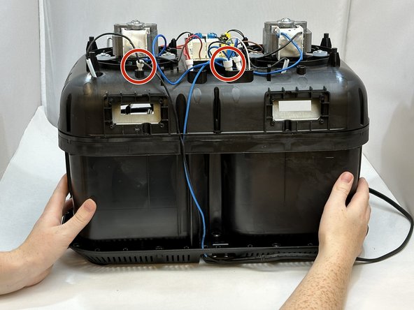

  8. Ninja Foodi DZ401 Power Cord Replacement, Power Cord: crwdns2935265:08crwdnd2935265:01crwdnd2935265:02crwdne2935265:0 Ninja Foodi DZ401 Power Cord Replacement, Power Cord: crwdns2935265:08crwdnd2935265:02crwdnd2935265:02crwdne2935265:0
    • Rotate the unit so that you can access the top and rear.
    • Locate and extract the black and blue wire bundles.
  9. Ninja Foodi DZ401 Power Cord Replacement: crwdns2935265:09crwdnd2935265:01crwdnd2935265:03crwdne2935265:0 Ninja Foodi DZ401 Power Cord Replacement: crwdns2935265:09crwdnd2935265:02crwdnd2935265:03crwdne2935265:0 Ninja Foodi DZ401 Power Cord Replacement: crwdns2935265:09crwdnd2935265:03crwdnd2935265:03crwdne2935265:0
    • Using pliers, gently uncrimp and remove the plastic wire cap from the blue and black wires.
    • Carefully separate the wires.
    • The wires may be sharp. Use pliers to reduce the risk of harm.

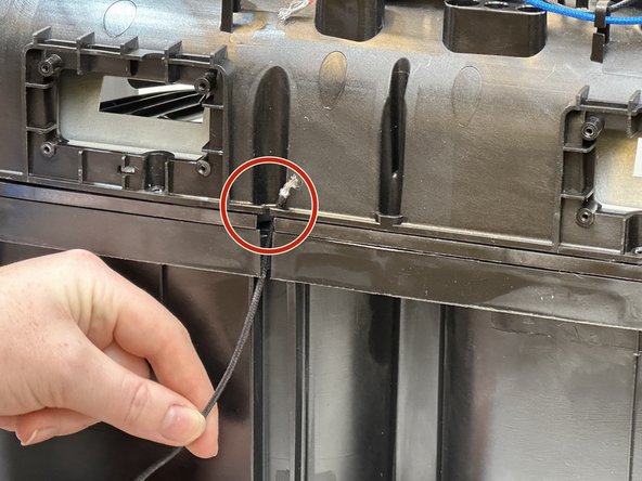

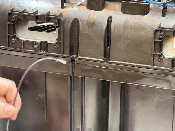

  10. Ninja Foodi DZ401 Power Cord Replacement: crwdns2935265:010crwdnd2935265:01crwdnd2935265:03crwdne2935265:0 Ninja Foodi DZ401 Power Cord Replacement: crwdns2935265:010crwdnd2935265:02crwdnd2935265:03crwdne2935265:0 Ninja Foodi DZ401 Power Cord Replacement: crwdns2935265:010crwdnd2935265:03crwdnd2935265:03crwdne2935265:0
    • Locate the blue and black wires that connect to the bottom of the unit.
    • Gently pull both wires out from the back of the unit.
    • Both wires run through a small channel that may impede removal. Use caution when extracting the wires from this area.

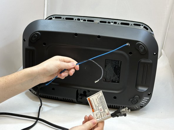

  11. Ninja Foodi DZ401 Power Cord Replacement: crwdns2935265:011crwdnd2935265:01crwdnd2935265:02crwdne2935265:0 Ninja Foodi DZ401 Power Cord Replacement: crwdns2935265:011crwdnd2935265:02crwdnd2935265:02crwdne2935265:0
    • Slightly lift the unit to allow the wires to come out easily.
    • Gently pull the blue and black wires through the base.
