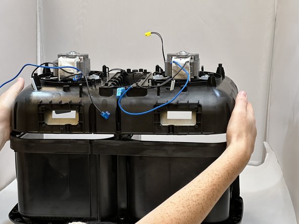

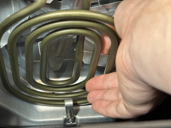

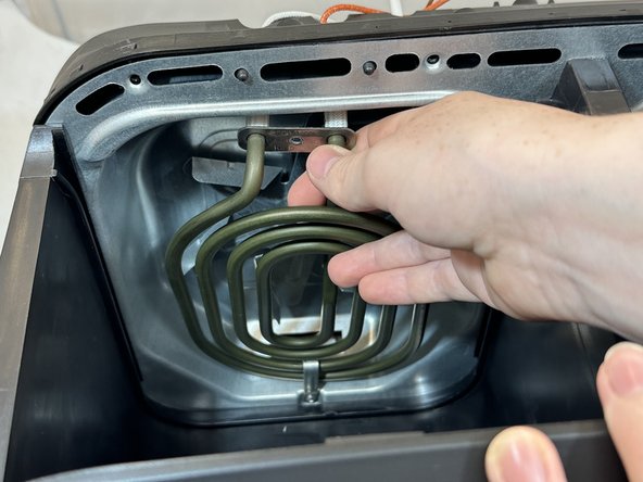

  8. Ninja Foodi DZ401 Fan Blades Replacement, Heating Element: crwdns2935265:08crwdnd2935265:01crwdnd2935265:01crwdne2935265:0
    • Rotate the air fryer so that the front is facing you and the top is accessible.
  9. Ninja Foodi DZ401 Fan Blades Replacement: crwdns2935265:09crwdnd2935265:01crwdnd2935265:03crwdne2935265:0 Ninja Foodi DZ401 Fan Blades Replacement: crwdns2935265:09crwdnd2935265:02crwdnd2935265:03crwdne2935265:0 Ninja Foodi DZ401 Fan Blades Replacement: crwdns2935265:09crwdnd2935265:03crwdnd2935265:03crwdne2935265:0
    • Locate the brown/orange wire bundle at the front of the air fryer and extract it.
    • Locate the white wire bundle at the rear of the air fryer and extract it.
    • Using pliers, uncrimp and remove the plastic wire caps.
    • Carefully separate the wires.
    • The wires may be sharp. Use pliers to increase safety.
  10. Ninja Foodi DZ401 Fan Blades Replacement: crwdns2935265:010crwdnd2935265:01crwdnd2935265:02crwdne2935265:0 Ninja Foodi DZ401 Fan Blades Replacement: crwdns2935265:010crwdnd2935265:02crwdnd2935265:02crwdne2935265:0
    • Remove the white wire from the three guiding hooks.
  11. Ninja Foodi DZ401 Fan Blades Replacement: crwdns2935265:011crwdnd2935265:01crwdnd2935265:03crwdne2935265:0 Ninja Foodi DZ401 Fan Blades Replacement: crwdns2935265:011crwdnd2935265:02crwdnd2935265:03crwdne2935265:0 Ninja Foodi DZ401 Fan Blades Replacement: crwdns2935265:011crwdnd2935265:03crwdnd2935265:03crwdne2935265:0
    • Remove the single 10.9 mm screw from the front of the heating element using a Phillips #2 screwdriver.
    • Gently pull down the heating element from the front.
    • The element wires should come out of their respective holes.
    • Unhook the heating element from the rear hook.

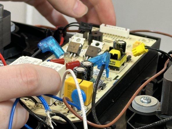

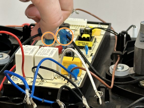

  12. Ninja Foodi DZ401 Fan Blades Replacement, Motherboard: crwdns2935265:012crwdnd2935265:01crwdnd2935265:01crwdne2935265:0
  13. Ninja Foodi DZ401 Fan Blades Replacement: crwdns2935265:013crwdnd2935265:01crwdnd2935265:03crwdne2935265:0 Ninja Foodi DZ401 Fan Blades Replacement: crwdns2935265:013crwdnd2935265:02crwdnd2935265:03crwdne2935265:0 Ninja Foodi DZ401 Fan Blades Replacement: crwdns2935265:013crwdnd2935265:03crwdnd2935265:03crwdne2935265:0
    • Extract the white, red, blue, and black wire bundles.
    • Using pliers, gently uncrimp and remove the plastic wire caps.
    • The wires may be sharp. Use pliers for increased safety.

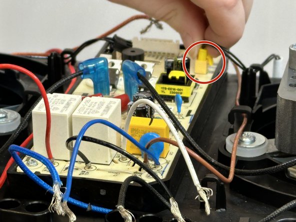

  14. Ninja Foodi DZ401 Fan Blades Replacement: crwdns2935265:014crwdnd2935265:01crwdnd2935265:03crwdne2935265:0 Ninja Foodi DZ401 Fan Blades Replacement: crwdns2935265:014crwdnd2935265:02crwdnd2935265:03crwdne2935265:0 Ninja Foodi DZ401 Fan Blades Replacement: crwdns2935265:014crwdnd2935265:03crwdnd2935265:03crwdne2935265:0
    • Disconnect black and yellow cords from the motherboard.
    • The black cord is labeled NTCR on the motherboard.
    • The yellow cord is labeled NTCL on the motherboard.
    • To disconnect, squeeze down the tab and pull the connector.
    • Disconnect both tab connectors.
    • The connectors are labeled FANL and FANR on the motherboard.
    • To disconnect, tightly grasp the connector and pull it up from the motherboard.
  15. Ninja Foodi DZ401 Fan Blades Replacement: crwdns2935265:015crwdnd2935265:01crwdnd2935265:02crwdne2935265:0 Ninja Foodi DZ401 Fan Blades Replacement: crwdns2935265:015crwdnd2935265:02crwdnd2935265:02crwdne2935265:0
    • Remove the four 13 mm mounting screws using a Phillips #1 screwdriver.
    • Carefully lift the motherboard up and remove it from the air fryer.
    • Only touch the outer edges of the motherboard to prevent component damage.

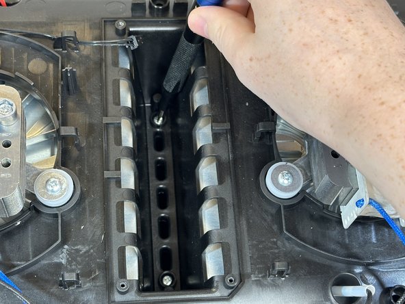

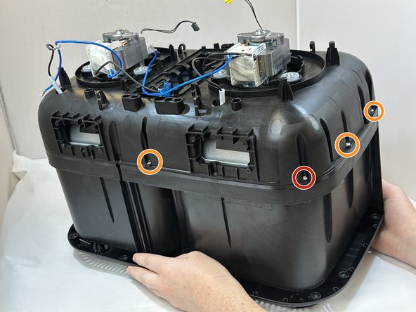

  16. Ninja Foodi DZ401 Fan Blades Replacement, Fan Blades: crwdns2935265:016crwdnd2935265:01crwdnd2935265:02crwdne2935265:0 Ninja Foodi DZ401 Fan Blades Replacement, Fan Blades: crwdns2935265:016crwdnd2935265:02crwdnd2935265:02crwdne2935265:0
    • Remove the six 16.8 mm screws (2 on the sides, 1 on the front, 1 on the back) using a Phillips #1 screwdriver.
    • Rotate the air fryer 180 degrees, so that the other four 16.8 mm screws are visible.
    • Remove the two 22.6 mm rear corner screws using a Phillips #1 screwdriver.
  17. Ninja Foodi DZ401 Fan Blades Replacement: crwdns2935265:017crwdnd2935265:01crwdnd2935265:03crwdne2935265:0 Ninja Foodi DZ401 Fan Blades Replacement: crwdns2935265:017crwdnd2935265:02crwdnd2935265:03crwdne2935265:0 Ninja Foodi DZ401 Fan Blades Replacement: crwdns2935265:017crwdnd2935265:03crwdnd2935265:03crwdne2935265:0
    • Remove the motherboard mounting tray.
    • Remove the two 16.8 mm interior screws using a Phillips #1 screwdriver.
    • Detach the top of the air fryer from the base.
  18. Ninja Foodi DZ401 Fan Blades Replacement: crwdns2935265:018crwdnd2935265:01crwdnd2935265:03crwdne2935265:0 Ninja Foodi DZ401 Fan Blades Replacement: crwdns2935265:018crwdnd2935265:02crwdnd2935265:03crwdne2935265:0 Ninja Foodi DZ401 Fan Blades Replacement: crwdns2935265:018crwdnd2935265:03crwdnd2935265:03crwdne2935265:0

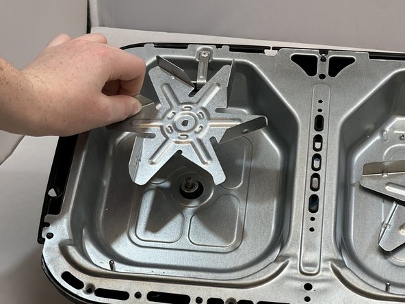

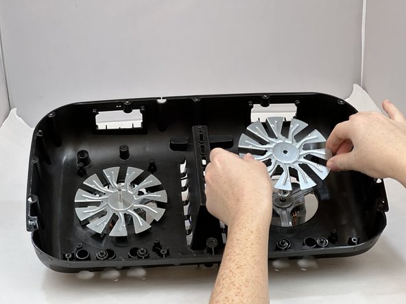

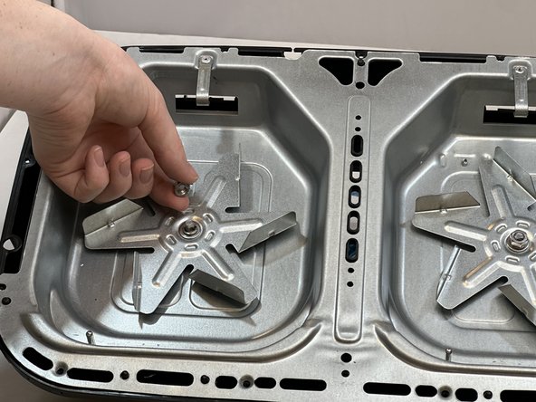

    • Rotate the top fan case so that the top is facing down and the fan blades are accessible.
  19. Ninja Foodi DZ401 Fan Blades Replacement: crwdns2935265:019crwdnd2935265:01crwdnd2935265:03crwdne2935265:0 Ninja Foodi DZ401 Fan Blades Replacement: crwdns2935265:019crwdnd2935265:02crwdnd2935265:03crwdne2935265:0 Ninja Foodi DZ401 Fan Blades Replacement: crwdns2935265:019crwdnd2935265:03crwdnd2935265:03crwdne2935265:0
    • Using an adjustable wrench, remove the bolt holding the fan on.
    • Using your opposite hand, hold onto the blade to keep it from spinning.
    • Remove the fan blade.

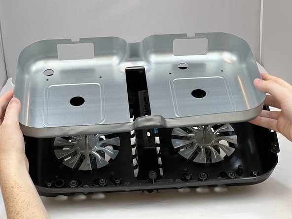

  20. Ninja Foodi DZ401 Fan Blades Replacement: crwdns2935265:020crwdnd2935265:01crwdnd2935265:02crwdne2935265:0 Ninja Foodi DZ401 Fan Blades Replacement: crwdns2935265:020crwdnd2935265:02crwdnd2935265:02crwdne2935265:0
    • Remove the two 16.8 mm screws from the middle of the exterior metal case.
    • Remove the four 12.2 mm screws from the bottom of the exterior metal case.
    • Remove the exterior metal case.
  21. Ninja Foodi DZ401 Fan Blades Replacement: crwdns2935265:021crwdnd2935265:01crwdnd2935265:03crwdne2935265:0 Ninja Foodi DZ401 Fan Blades Replacement: crwdns2935265:021crwdnd2935265:02crwdnd2935265:03crwdne2935265:0 Ninja Foodi DZ401 Fan Blades Replacement: crwdns2935265:021crwdnd2935265:03crwdnd2935265:03crwdne2935265:0
    • Remove the eight 16.7 mm screws holding on the interior metal case.
    • Remove the case.
    • Remove the interior fan blade.
