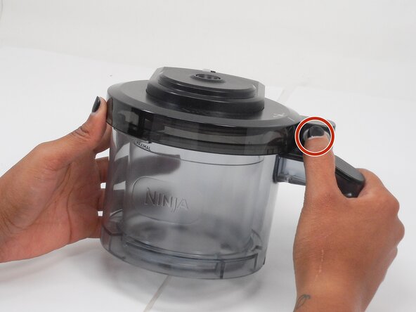

    • Press and hold the lid unlock button to disengage the locking mechanism.

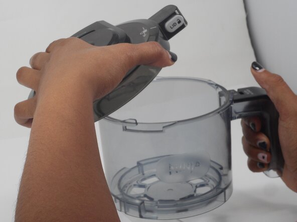

    • While holding the button, lift the lid straight up to remove it from the bowl.

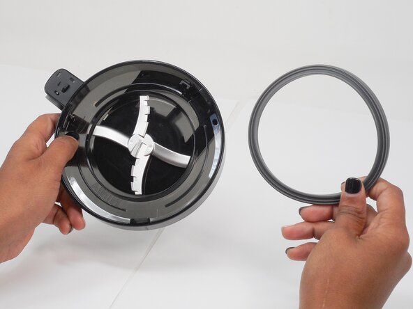

    • Flip the lid over to expose the underside.
    • Do not touch the blades.
    • Around the inside edge of the lid, identify the silicone seal sitting inside a circular groove.
    • Use your fingers to gently lift the edge of the silicone seal from the groove.
    • Slowly peel the seal out, working your way around the entire perimeter.
