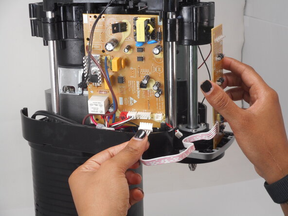

  4. Ninja Creami Rotating Shaft Replacement, Daughterboard: crwdns2935265:04crwdnd2935265:01crwdnd2935265:02crwdne2935265:0 Ninja Creami Rotating Shaft Replacement, Daughterboard: crwdns2935265:04crwdnd2935265:02crwdnd2935265:02crwdne2935265:0
    • Disconnect the daughterboard's motherboard connector.
    • Remove the daughter board.

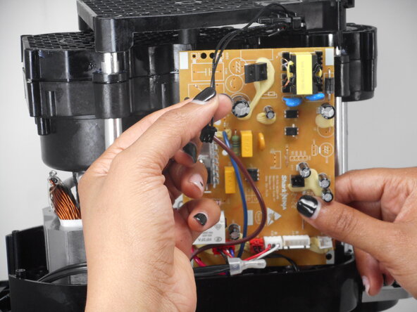

  5. Ninja Creami Rotating Shaft Replacement, Rotating Shaft: crwdns2935265:05crwdnd2935265:01crwdnd2935265:02crwdne2935265:0 Ninja Creami Rotating Shaft Replacement, Rotating Shaft: crwdns2935265:05crwdnd2935265:02crwdnd2935265:02crwdne2935265:0
    • Disconnect the black connector from motherboard.

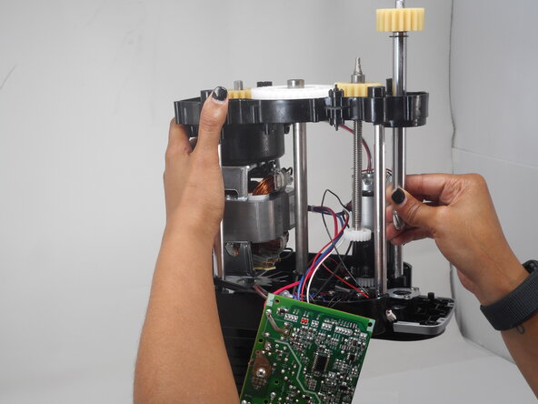

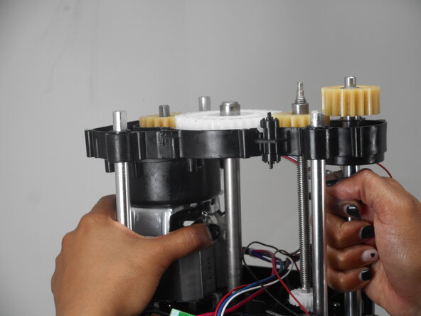

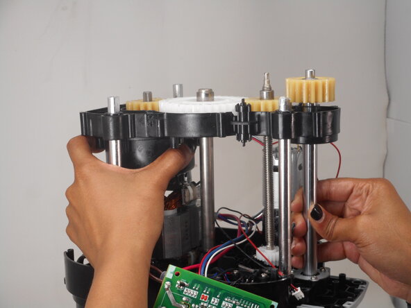

  6. Ninja Creami Rotating Shaft Replacement: crwdns2935265:06crwdnd2935265:01crwdnd2935265:03crwdne2935265:0 Ninja Creami Rotating Shaft Replacement: crwdns2935265:06crwdnd2935265:02crwdnd2935265:03crwdne2935265:0 Ninja Creami Rotating Shaft Replacement: crwdns2935265:06crwdnd2935265:03crwdnd2935265:03crwdne2935265:0
    • Remove the top of the gear housing while holding the bottom in place.

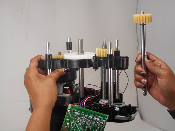

  7. Ninja Creami Rotating Shaft Replacement: crwdns2935265:07crwdnd2935265:01crwdnd2935265:03crwdne2935265:0 Ninja Creami Rotating Shaft Replacement: crwdns2935265:07crwdnd2935265:02crwdnd2935265:03crwdne2935265:0 Ninja Creami Rotating Shaft Replacement: crwdns2935265:07crwdnd2935265:03crwdnd2935265:03crwdne2935265:0
    • Hold the bottom of the gear housing above the shafts that it is on and pull out the rotating shaft.
