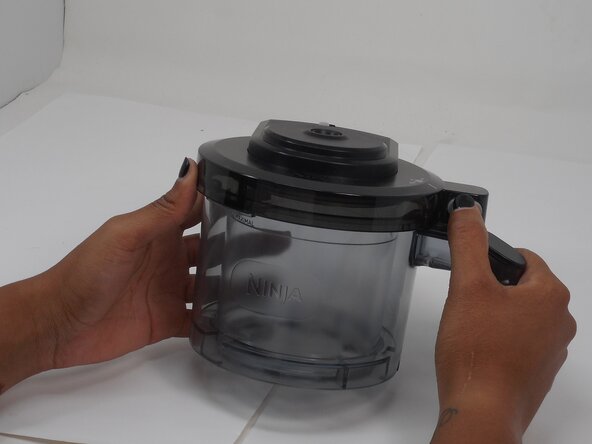

    • Press and hold the lid unlock button to disengage the locking mechanism.
    • While holding the button, lift the lid straight up to remove it from the bowl.

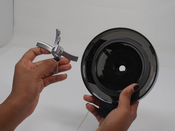

    • Pull on the release mechanism for the paddle blade.
    • Remove the paddle blade from the lid.
