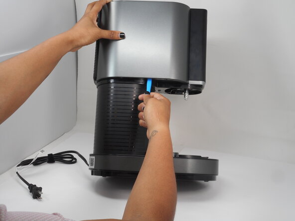

    • Use an opening tool to gently lift and remove the grey cover from the top of the main piece.
    • Start at one edge and work your way around to avoid cracking the housing.

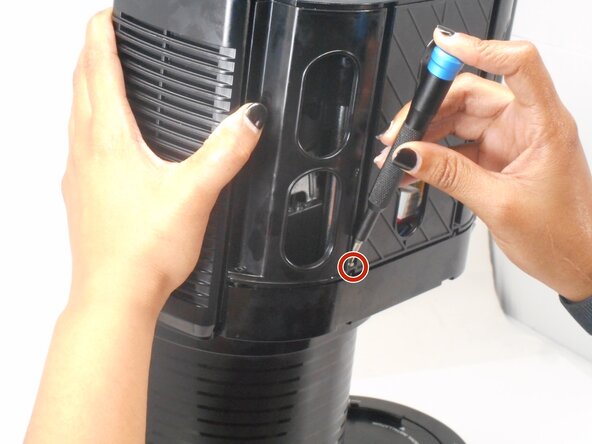

    • Remove the ten 13.6 mm Phillips screws from the perimeter of the outer cover.
    • Lift the black plastic cover straight up and off.

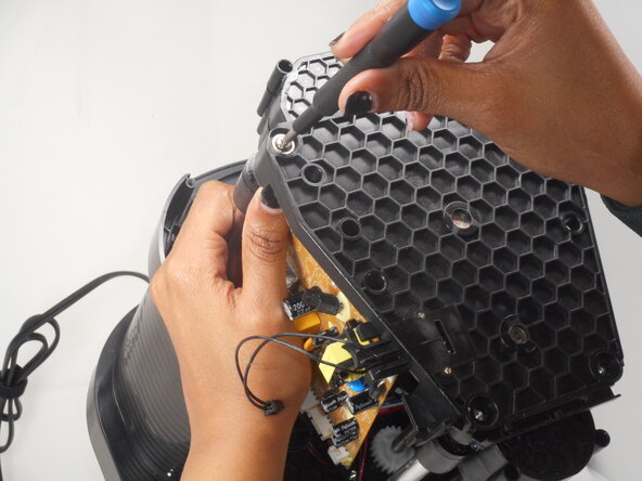

    • Remove the four 12.2 mm Phillips screws from the black plastic cover.
