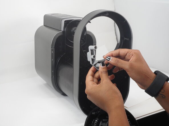

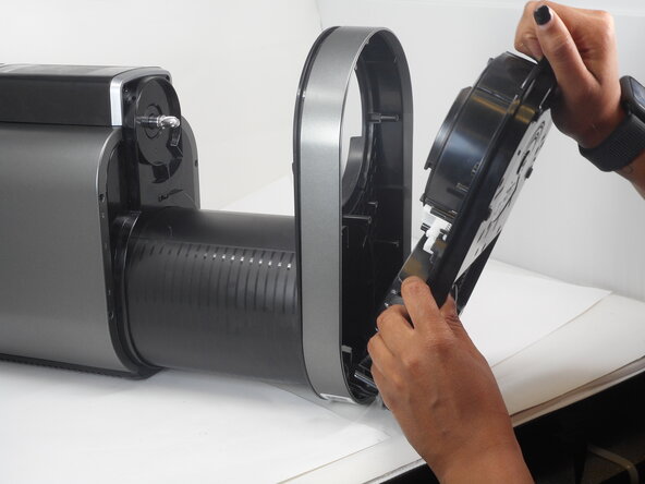

    • Remove the thirteen 14.0 mm Phillips screws from the bottom platform.
    • Pry and remove the bottom platform
  2. Ninja Creami Outer Bowl Release Button Spring Replacement: crwdns2935265:02crwdnd2935265:01crwdnd2935265:03crwdne2935265:0 Ninja Creami Outer Bowl Release Button Spring Replacement: crwdns2935265:02crwdnd2935265:02crwdnd2935265:03crwdne2935265:0 Ninja Creami Outer Bowl Release Button Spring Replacement: crwdns2935265:02crwdnd2935265:03crwdnd2935265:03crwdne2935265:0

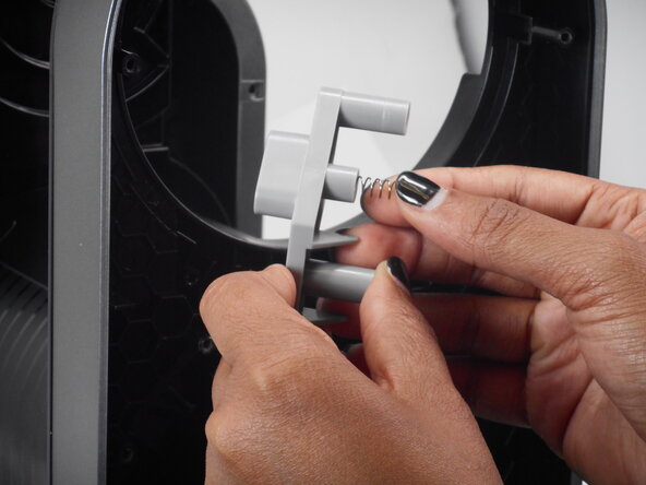

    • Remove the grey release button that holds the springs.
    • Remove the two springs located inside of the grey release button and replace them.
