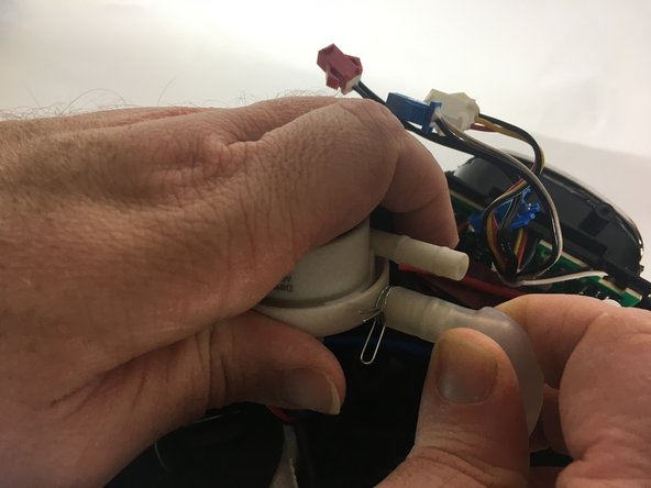

  12. Ninja Coffee Bar CF086 Water Pump Replacement, Water Pump: crwdns2935265:012crwdnd2935265:01crwdnd2935265:03crwdne2935265:0 Ninja Coffee Bar CF086 Water Pump Replacement, Water Pump: crwdns2935265:012crwdnd2935265:02crwdnd2935265:03crwdne2935265:0 Ninja Coffee Bar CF086 Water Pump Replacement, Water Pump: crwdns2935265:012crwdnd2935265:03crwdnd2935265:03crwdne2935265:0
    • Locate the water pump in the interior of your device.
    • Squeeze and remove the clamps securing the tubes that are connected to the side of the water pump.

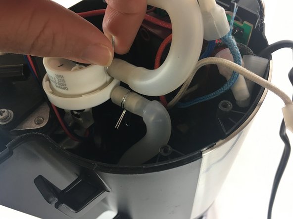

  13. Ninja Coffee Bar CF086 Water Pump Replacement: crwdns2935265:013crwdnd2935265:01crwdnd2935265:03crwdne2935265:0 Ninja Coffee Bar CF086 Water Pump Replacement: crwdns2935265:013crwdnd2935265:02crwdnd2935265:03crwdne2935265:0 Ninja Coffee Bar CF086 Water Pump Replacement: crwdns2935265:013crwdnd2935265:03crwdnd2935265:03crwdne2935265:0
    • Remove the tubes attached to the side of the water pump.
  14. Ninja Coffee Bar CF086 Water Pump Replacement: crwdns2935265:014crwdnd2935265:01crwdnd2935265:03crwdne2935265:0 Ninja Coffee Bar CF086 Water Pump Replacement: crwdns2935265:014crwdnd2935265:02crwdnd2935265:03crwdne2935265:0 Ninja Coffee Bar CF086 Water Pump Replacement: crwdns2935265:014crwdnd2935265:03crwdnd2935265:03crwdne2935265:0
    • Trace the three wires leading out of the water pump until you find the connector linking them to the wires in your device.
    • Detach the connector and remove the water pump.
