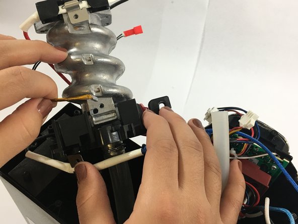

    • Grasp and remove the clamp securing the tube that feeds into the base of the water heating element.
    • Detach the tube from the water heating element.

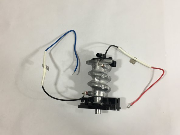

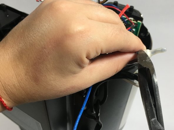

    • Locate the two wires leading out from the water heating element that feed into crimp connectors.
    • Using side cutters, sever these wires near the crimp connectors.
    • Use the side cutters to cut the remaining wires that feed into the crimp connectors from the coffee machine.

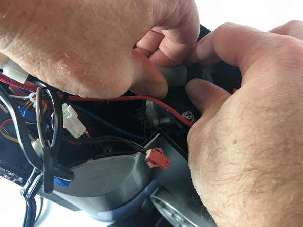

    • Squeeze and remove the clamp that secures the main tube feeding into the water heating element. Remove that tube.
    • Remove the water heating element.

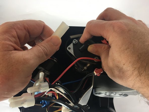

  10. Ninja Coffee Bar CF086 Water Heating Element Replacement: crwdns2935265:010crwdnd2935265:01crwdnd2935265:03crwdne2935265:0 Ninja Coffee Bar CF086 Water Heating Element Replacement: crwdns2935265:010crwdnd2935265:02crwdnd2935265:03crwdne2935265:0 Ninja Coffee Bar CF086 Water Heating Element Replacement: crwdns2935265:010crwdnd2935265:03crwdnd2935265:03crwdne2935265:0

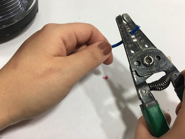

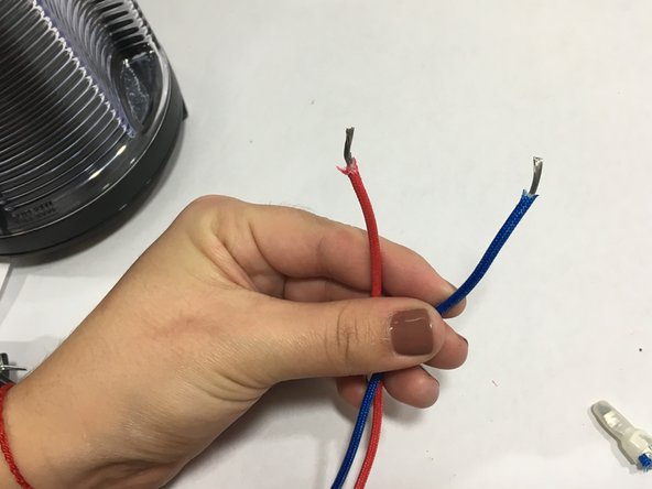

    • Using wire strippers, strip the cut wires from your coffee machine near their cut ends to expose 2 cm of metal conductor from each.
    • Use a similar procedure to strip the wires from your replacement heating element. Using wire strippers, expose 2 cm of metal conductor from the ends of the wires.
  11. Ninja Coffee Bar CF086 Water Heating Element Replacement: crwdns2935265:011crwdnd2935265:01crwdnd2935265:01crwdne2935265:0
    • Prepare two crimp connectors by filling them with dielectric grease.
    • Use a crimp connector to connect a stripped end of the wire leading from the replacement heating element to the stripped end of the corresponding wire from the coffee maker.
    • Using a second crimp connector, repeat for the remaining pair of stripped wires.
    • Using the appropriate crimping tool, crimp the connectors.
