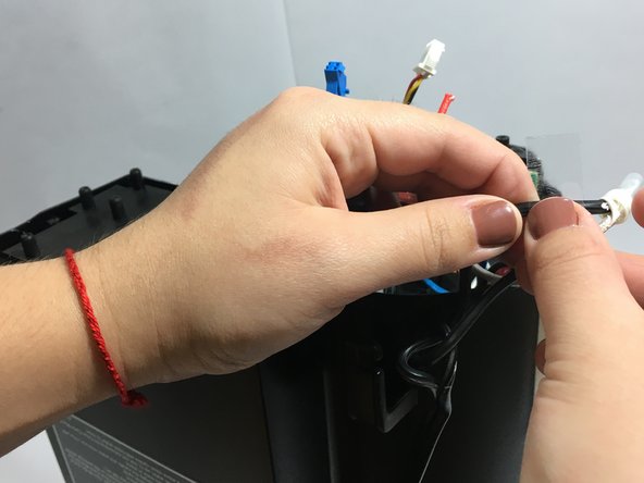

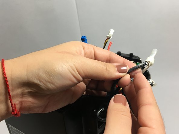

    • The power cord splits into two and feeds into two closed-end crimp connectors. Two wires from your coffee machine also enter these connectors.
    • Locate the neutral wire that feeds into the crimp connector from the machine. Mark this wire.
  13. Ninja Coffee Bar CF086 Power Cord Replacement: crwdns2935265:013crwdnd2935265:01crwdnd2935265:02crwdne2935265:0 Ninja Coffee Bar CF086 Power Cord Replacement: crwdns2935265:013crwdnd2935265:02crwdnd2935265:02crwdne2935265:0
    • Using side cutters, cut the wires from your device below the crimp connectors.

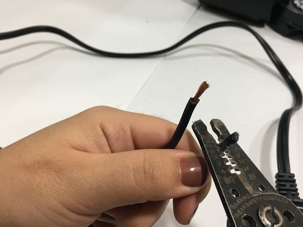

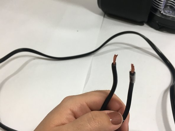

    • Using wire strippers, carefully expose a 2 cm length of the metal wire from each of the cut ends.

    • Locate the ends of the replacement power cord. These should be already stripped; if they are not, strip 2 cm from them using wire strippers.
    • Feed the ends of the replacement power cord into the crimp connectors. Crimp the connectors using the appropriate crimping tool.
After the wires have been spliced, the new power cord is ready for use with your machine.
