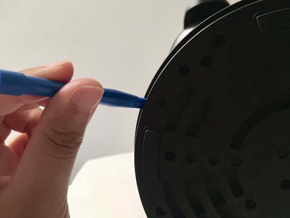

  3. Ninja Coffee Bar CF080 Water Pump  Replacement: crwdns2935265:03crwdnd2935265:01crwdnd2935265:03crwdne2935265:0 Ninja Coffee Bar CF080 Water Pump  Replacement: crwdns2935265:03crwdnd2935265:02crwdnd2935265:03crwdne2935265:0 Ninja Coffee Bar CF080 Water Pump  Replacement: crwdns2935265:03crwdnd2935265:03crwdnd2935265:03crwdne2935265:0
    • With moderate force remove and place the "plastic opening tool" between the divide in order to remove the bottom board.

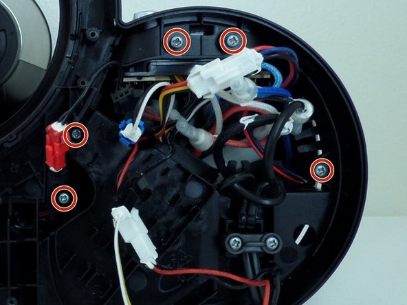

  8. Ninja Coffee Bar CF080 Water Pump  Replacement, Power Module: crwdns2935265:08crwdnd2935265:01crwdnd2935265:03crwdne2935265:0 Ninja Coffee Bar CF080 Water Pump  Replacement, Power Module: crwdns2935265:08crwdnd2935265:02crwdnd2935265:03crwdne2935265:0 Ninja Coffee Bar CF080 Water Pump  Replacement, Power Module: crwdns2935265:08crwdnd2935265:03crwdnd2935265:03crwdne2935265:0
    • Remove the nine 0.5cm screws with Phillips #2 screwdriver.
    • Some screws are harder to see due to how deep the holes are.
    • Recommend using Extender 4 with Phillips #2 screwdriver to help unscrew the screws within the deep holes of the machine.

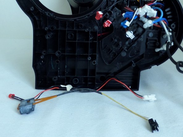

  10. Ninja Coffee Bar CF080 Water Pump  Replacement: crwdns2935265:010crwdnd2935265:01crwdnd2935265:03crwdne2935265:0 Ninja Coffee Bar CF080 Water Pump  Replacement: crwdns2935265:010crwdnd2935265:02crwdnd2935265:03crwdne2935265:0 Ninja Coffee Bar CF080 Water Pump  Replacement: crwdns2935265:010crwdnd2935265:03crwdnd2935265:03crwdne2935265:0
    • Detach various colored cords from one another, using both hands to place thumb and index finger to hold each grip then separate by pulling with the degree of force.
    • There with be 1 blue, 1 black, 1 red and 2 white.

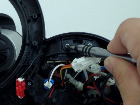

  15. Ninja Coffee Bar CF080 Water Pump  Replacement, Water Pump: crwdns2935265:015crwdnd2935265:01crwdnd2935265:03crwdne2935265:0 Ninja Coffee Bar CF080 Water Pump  Replacement, Water Pump: crwdns2935265:015crwdnd2935265:02crwdnd2935265:03crwdne2935265:0 Ninja Coffee Bar CF080 Water Pump  Replacement, Water Pump: crwdns2935265:015crwdnd2935265:03crwdnd2935265:03crwdne2935265:0
    • Remove the three 0.6 cm screws, using Phillips #1 screwdriver with Extender 4.
    • Screws are hidden within the machine.

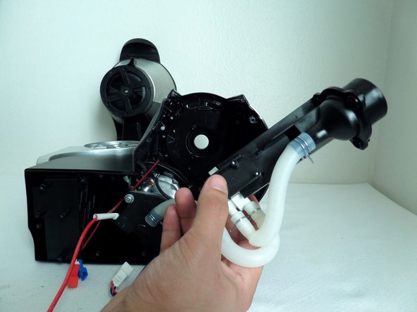

  16. Ninja Coffee Bar CF080 Water Pump  Replacement: crwdns2935265:016crwdnd2935265:01crwdnd2935265:02crwdne2935265:0 Ninja Coffee Bar CF080 Water Pump  Replacement: crwdns2935265:016crwdnd2935265:02crwdnd2935265:02crwdne2935265:0
    • Pull the water tube towards you to detach the water's tube top from the machine.

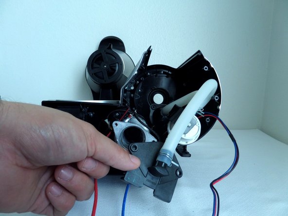

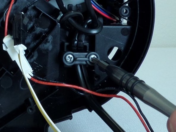

  17. Ninja Coffee Bar CF080 Water Pump  Replacement: crwdns2935265:017crwdnd2935265:01crwdnd2935265:01crwdne2935265:0
    • Remove the two 0.8 cm screws with Phillips #1 screwdriver.
  18. Ninja Coffee Bar CF080 Water Pump  Replacement: crwdns2935265:018crwdnd2935265:01crwdnd2935265:02crwdne2935265:0 Ninja Coffee Bar CF080 Water Pump  Replacement: crwdns2935265:018crwdnd2935265:02crwdnd2935265:02crwdne2935265:0
    • Grip on the diamond shaped black holder lid and pull it away to separate the tube from the machine.
    • Be careful and remove with ease as the lid is holding white tube below it.
