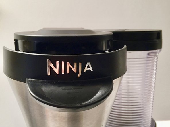

    • Face the coffee machine in front of you.
    • Make sure that the coffee machine is unplugged.
    • Remove the glass carafe as it will not be needed.
  2. Ninja Coffee Bar CF080 Brewer Head Replacement: crwdns2935265:02crwdnd2935265:01crwdnd2935265:01crwdne2935265:0
    • Firmly grab the tab sticking out from the head of the brewer.
  3. Ninja Coffee Bar CF080 Brewer Head Replacement: crwdns2935265:03crwdnd2935265:01crwdnd2935265:03crwdne2935265:0 Ninja Coffee Bar CF080 Brewer Head Replacement: crwdns2935265:03crwdnd2935265:02crwdnd2935265:03crwdne2935265:0 Ninja Coffee Bar CF080 Brewer Head Replacement: crwdns2935265:03crwdnd2935265:03crwdnd2935265:03crwdne2935265:0
    • With little force, pull the tab of the brewer head in reverse direction.
  4. Ninja Coffee Bar CF080 Brewer Head Replacement: crwdns2935265:04crwdnd2935265:01crwdnd2935265:01crwdne2935265:0
    • Slide off the head in the direction away from the machine.
    • If the head does not come off smoothly by sliding, give a firm tug in the same direction.
  5. Ninja Coffee Bar CF080 Brewer Head Replacement: crwdns2935265:05crwdnd2935265:01crwdnd2935265:03crwdne2935265:0 Ninja Coffee Bar CF080 Brewer Head Replacement: crwdns2935265:05crwdnd2935265:02crwdnd2935265:03crwdne2935265:0 Ninja Coffee Bar CF080 Brewer Head Replacement: crwdns2935265:05crwdnd2935265:03crwdnd2935265:03crwdne2935265:0
    • Hold the head in the same position and lift it forward until the Ninja is facing upward toward the ceiling.

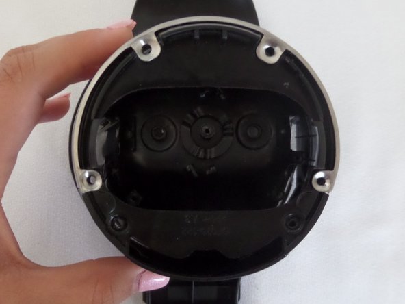

  6. Ninja Coffee Bar CF080 Brewer Head Replacement: crwdns2935265:06crwdnd2935265:01crwdnd2935265:01crwdne2935265:0
    • Now the brewer head is positioned to where you can seeing the bottom.
  7. Ninja Coffee Bar CF080 Brewer Head Replacement: crwdns2935265:07crwdnd2935265:01crwdnd2935265:02crwdne2935265:0 Ninja Coffee Bar CF080 Brewer Head Replacement: crwdns2935265:07crwdnd2935265:02crwdnd2935265:02crwdne2935265:0
    • Remove the screw with a Phillips #1 screwdriver.
    • Use Phillips #1 screwdriver.
    • Along will come a small black screw cover and spring
  8. Ninja Coffee Bar CF080 Brewer Head Replacement: crwdns2935265:08crwdnd2935265:01crwdnd2935265:01crwdne2935265:0
    • Twist the black lid on top clockwise until it is completely detached.
  9. Ninja Coffee Bar CF080 Brewer Head Replacement: crwdns2935265:09crwdnd2935265:01crwdnd2935265:01crwdne2935265:0
    • With the black upper lid detached, a smaller black cover can be removed without effort.
  10. Ninja Coffee Bar CF080 Brewer Head Replacement: crwdns2935265:010crwdnd2935265:01crwdnd2935265:02crwdne2935265:0 Ninja Coffee Bar CF080 Brewer Head Replacement: crwdns2935265:010crwdnd2935265:02crwdnd2935265:02crwdne2935265:0
    • Remove the 6 screws from the seal with a Phillips #1 screwdriver.
  11. Ninja Coffee Bar CF080 Brewer Head Replacement: crwdns2935265:011crwdnd2935265:01crwdnd2935265:01crwdne2935265:0
    • Once all screws are detached from the brewer head, it will be separated into two pieces leaving the filter.
