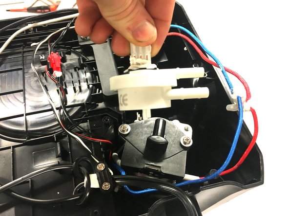

Ninja Coffee Bar® Single-Serve System Water Regulating Valve Replacement
  1. Ninja Coffee Bar® Single-Serve System Water Regulating Valve Replacement, Valve: crwdns2935265:01crwdnd2935265:01crwdnd2935265:01crwdne2935265:0
    • Unscrew eight 6mm screws with Phillips head #1 screwdriver
    • Remove bottom cover
  2. Ninja Coffee Bar® Single-Serve System Water Regulating Valve Replacement: crwdns2935265:02crwdnd2935265:01crwdnd2935265:01crwdne2935265:0
    • Unscrew three 6mm screws with Phillips head #1 screwdriver
    • Remover tube protection plate
  3. Ninja Coffee Bar® Single-Serve System Water Regulating Valve Replacement: crwdns2935265:03crwdnd2935265:01crwdnd2935265:02crwdne2935265:0 Ninja Coffee Bar® Single-Serve System Water Regulating Valve Replacement: crwdns2935265:03crwdnd2935265:02crwdnd2935265:02crwdne2935265:0
    • Detach valve tubes from valve by squeezing pins and pull tubes away from valve
