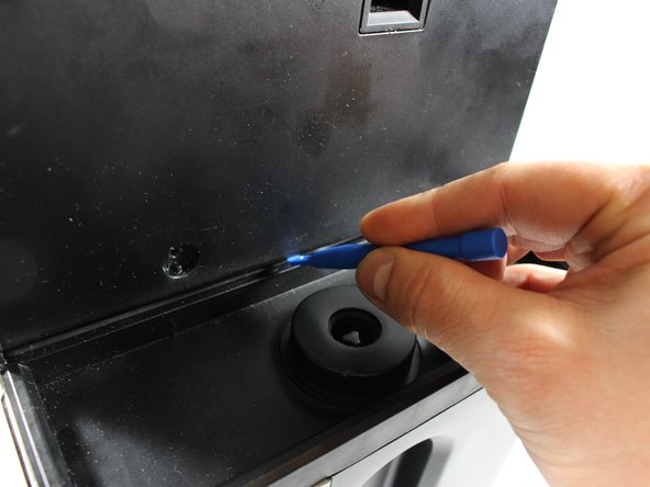

  6. Ninja Coffee Bar® Single-Serve System Water Heater Replacement: crwdns2935265:06crwdnd2935265:01crwdnd2935265:02crwdne2935265:0 Ninja Coffee Bar® Single-Serve System Water Heater Replacement: crwdns2935265:06crwdnd2935265:02crwdnd2935265:02crwdne2935265:0
    • Slowly pry the upper cover away from the unit on top of the brew basket, and near the base of the water reservoir along the side of the upper cover.

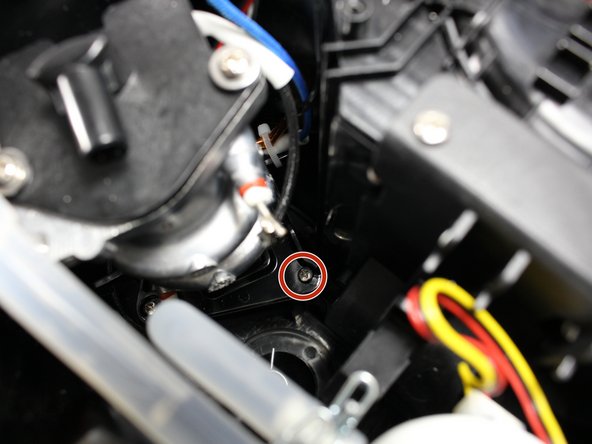

  7. Ninja Coffee Bar® Single-Serve System Water Heater Replacement: crwdns2935265:07crwdnd2935265:01crwdnd2935265:01crwdne2935265:0
    • Separate hose from upper nozzle by squeezing the clamp and pulling the hose down slightly.
  8. Ninja Coffee Bar® Single-Serve System Water Heater Replacement: crwdns2935265:08crwdnd2935265:01crwdnd2935265:02crwdne2935265:0 Ninja Coffee Bar® Single-Serve System Water Heater Replacement: crwdns2935265:08crwdnd2935265:02crwdnd2935265:02crwdne2935265:0
    • Using a #1 Phillips head screwdriver with an extension, remove three 6mm screws holding the heater to the unit.
  9. Ninja Coffee Bar® Single-Serve System Water Heater Replacement: crwdns2935265:09crwdnd2935265:01crwdnd2935265:01crwdne2935265:0
    • Remove heater from unit.
  10. Ninja Coffee Bar® Single-Serve System Water Heater Replacement: crwdns2935265:010crwdnd2935265:01crwdnd2935265:02crwdne2935265:0 Ninja Coffee Bar® Single-Serve System Water Heater Replacement: crwdns2935265:010crwdnd2935265:02crwdnd2935265:02crwdne2935265:0
    • Squeeze clip and separate signal wiring.
    • Using wire stripper/crimping tool, uncrimp wiring connectors
    • Wiring connectors are sealed together making them difficult to disconnect. Cutting and rewiring should be considered.
