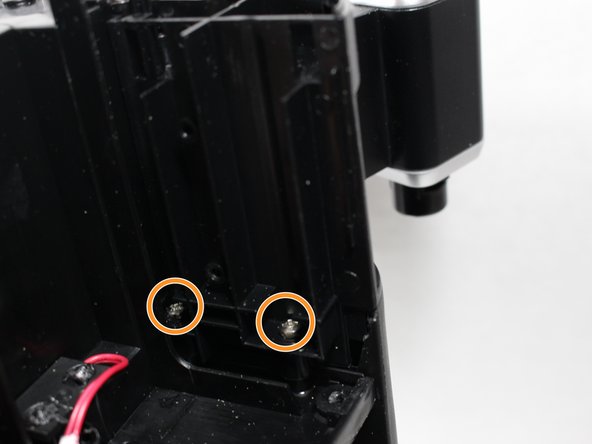

    • Remove the single 6mm #1 Phillips head screw from the top of the unit. (The two smaller screws should remain attached.)
    • Using an extension, remove the two 6mm Phillips head screws from the side of the frother motor pivot.

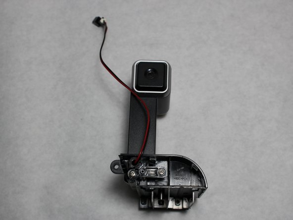

  4. Ninja Coffee Bar® Single-Serve System Frother Replacement: crwdns2935265:04crwdnd2935265:01crwdnd2935265:03crwdne2935265:0 Ninja Coffee Bar® Single-Serve System Frother Replacement: crwdns2935265:04crwdnd2935265:02crwdnd2935265:03crwdne2935265:0 Ninja Coffee Bar® Single-Serve System Frother Replacement: crwdns2935265:04crwdnd2935265:03crwdnd2935265:03crwdne2935265:0
    • Pinch power connector and pull lighly to separate.
    • Pull motor straight up to separate from unit.
