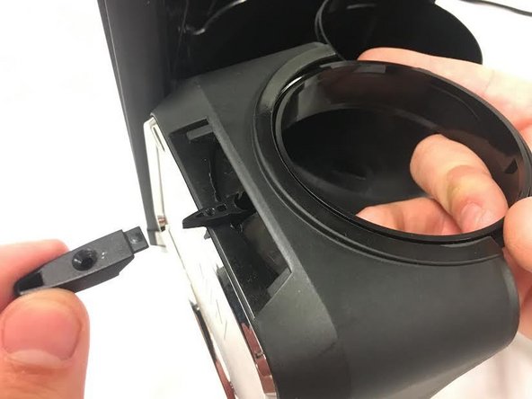

    • Slide the brew baskets to the open position.
  2. Ninja Coffee Bar® Single-Serve System Drip Stop Toggle and Brew Basket Replacement: crwdns2935265:02crwdnd2935265:01crwdnd2935265:01crwdne2935265:0
    • Remove three 6mm screws with Phillips head screw driver.
  3. Ninja Coffee Bar® Single-Serve System Drip Stop Toggle and Brew Basket Replacement: crwdns2935265:03crwdnd2935265:01crwdnd2935265:03crwdne2935265:0 Ninja Coffee Bar® Single-Serve System Drip Stop Toggle and Brew Basket Replacement: crwdns2935265:03crwdnd2935265:02crwdnd2935265:03crwdne2935265:0 Ninja Coffee Bar® Single-Serve System Drip Stop Toggle and Brew Basket Replacement: crwdns2935265:03crwdnd2935265:03crwdnd2935265:03crwdne2935265:0

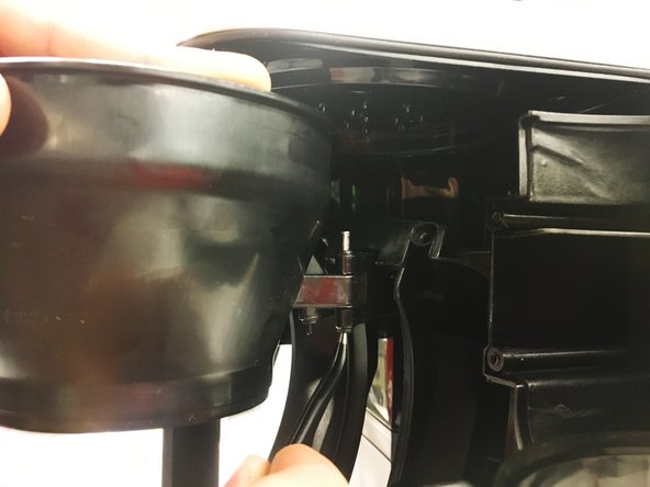

    • Using needle nose tweezers, push the bottom of the pin up from behind the brew basket
    • Pull the pin out.
  4. Ninja Coffee Bar® Single-Serve System Drip Stop Toggle and Brew Basket Replacement: crwdns2935265:04crwdnd2935265:01crwdnd2935265:01crwdne2935265:0
    • Remove brew basket from swinging basket holder
  5. Ninja Coffee Bar® Single-Serve System Drip Stop Toggle and Brew Basket Replacement: crwdns2935265:05crwdnd2935265:01crwdnd2935265:02crwdne2935265:0 Ninja Coffee Bar® Single-Serve System Drip Stop Toggle and Brew Basket Replacement: crwdns2935265:05crwdnd2935265:02crwdnd2935265:02crwdne2935265:0
    • Use a Phillips screwdriver to remove one 6mm screw from the drip stop toggle.
    • Remove the drip stop toggle.

Can you provide more detail regarding the small spring that you provide the warning for? The one that needs to stay in place. If it does fall out, how can not be fixed or rather where does not go?
Dani - crwdns2934203:0crwdne2934203:0
Agree! The spring NEEDS to be resting vertically in between the two clips, in my case, these have worn and the spring came out of seat. It needed to be refastened and the five beeps, “of death” have disappeared and my coffeepot functions again!
