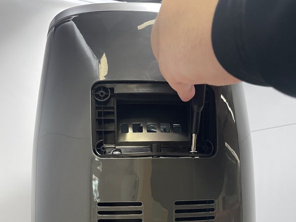

    • The back vent cover is directly above where the power cord protrudes.
  2. Ninja AF161 Max XL Fan Replacement: crwdns2935265:02crwdnd2935265:01crwdnd2935265:02crwdne2935265:0 Ninja AF161 Max XL Fan Replacement: crwdns2935265:02crwdnd2935265:02crwdnd2935265:02crwdne2935265:0
    • Use a Phillips #2 screwdriver to unscrew and remove four 1 cm screws from the panel.
  3. Ninja AF161 Max XL Fan Replacement: crwdns2935265:03crwdnd2935265:01crwdnd2935265:02crwdne2935265:0 Ninja AF161 Max XL Fan Replacement: crwdns2935265:03crwdnd2935265:02crwdnd2935265:02crwdne2935265:0
    • Once unscrewed, remove all four screws in order to remove the back vent cover.

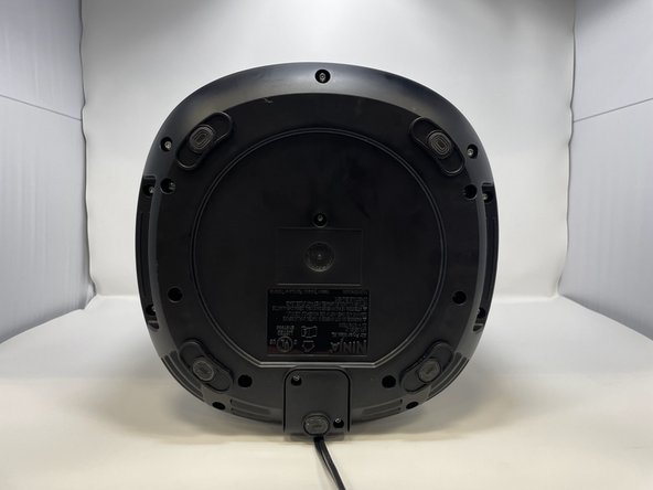

    • Lay the air fryer on its side.
  8. Ninja AF161 Max XL Fan Replacement: crwdns2935265:08crwdnd2935265:01crwdnd2935265:02crwdne2935265:0 Ninja AF161 Max XL Fan Replacement: crwdns2935265:08crwdnd2935265:02crwdnd2935265:02crwdne2935265:0
    • Remove six 1.4 cm screws with the TR15 Torx Security Screwdriver.

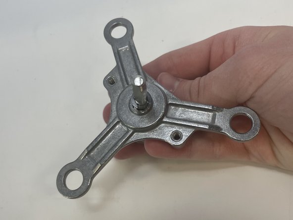

  13. Ninja AF161 Max XL Fan Replacement, Fan: crwdns2935265:013crwdnd2935265:01crwdnd2935265:03crwdne2935265:0 Ninja AF161 Max XL Fan Replacement, Fan: crwdns2935265:013crwdnd2935265:02crwdnd2935265:03crwdne2935265:0 Ninja AF161 Max XL Fan Replacement, Fan: crwdns2935265:013crwdnd2935265:03crwdnd2935265:03crwdne2935265:0
    • Remove the three 1.4 cm screws, washers, and rubber pieces from the triangular metal piece using a Phillips #1 screwdriver.
    • Remove the triangular metal piece from the device.

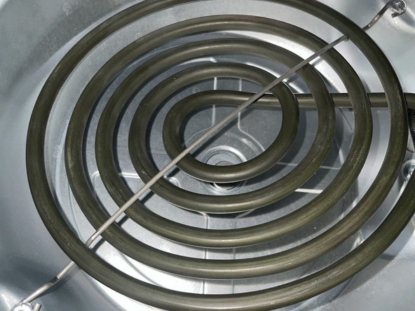

  16. Ninja AF161 Max XL Fan Replacement: crwdns2935265:016crwdnd2935265:01crwdnd2935265:02crwdne2935265:0 Ninja AF161 Max XL Fan Replacement: crwdns2935265:016crwdnd2935265:02crwdnd2935265:02crwdne2935265:0
    • Use a Phillips #1 screwdriver to remove the 1.4 cm screw that secures the heating element.
  17. Ninja AF161 Max XL Fan Replacement: crwdns2935265:017crwdnd2935265:01crwdnd2935265:03crwdne2935265:0 Ninja AF161 Max XL Fan Replacement: crwdns2935265:017crwdnd2935265:02crwdnd2935265:03crwdne2935265:0 Ninja AF161 Max XL Fan Replacement: crwdns2935265:017crwdnd2935265:03crwdnd2935265:03crwdne2935265:0
    • Carefully maneuver the fan from under the heating element to remove it from the device. Be cautious of the sharp edges of the fan.
    • Be mindful of the cylindrical piece and hex nut that sit on top of the fan when reassembling.
