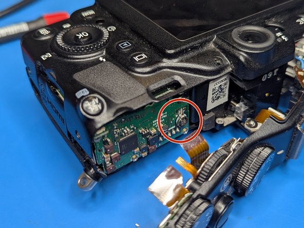

    • If your camera forgets all its settings as soon as you remove its battery it is most likely caused by a faulty internal battery. In this guide I will show you how to replace it for the p7000 model.
    • Please do this at your own risk, even though losing settings might be annoying. The risk of damaging the camera might not be worth the fix.
    • During my initial disassembly of the camera I lost track of the location of the different screws. Don't make the same mistake. There are three lengths of screws, note where they all come from.
    • This fix will also require soldering. If you are not comfortable, I would not attempt this fix. The part is small and mistakes could cost you your camera. The second picture is of the battery we are chasing, this should give you an idea of the size we are working with.

    • Now the top of the device can be lifted and the black tape can be removed to reveal the board that contains the internal battery. Measuring the voltage on the battery will indicate if it needs replacement (less than 2v is probably too low).
    • The circle marks the battery we've been after.

    • The original battery seems to be a FDK UT414 with solder tabls. It is best to find an exact replacement, but any 3v rechargeable battery with solder tabs will work. Please note the polarity of the tabs. With the solder tabs facing towards you the right leg should be positive.
  9. Nikon coolpix P7000 internal memory battery Replacement, Solder time!: crwdns2935265:09crwdnd2935265:01crwdnd2935265:03crwdne2935265:0 Nikon coolpix P7000 internal memory battery Replacement, Solder time!: crwdns2935265:09crwdnd2935265:02crwdnd2935265:03crwdne2935265:0 Nikon coolpix P7000 internal memory battery Replacement, Solder time!: crwdns2935265:09crwdnd2935265:03crwdnd2935265:03crwdne2935265:0
    • Now the new battery can be soldered into place. Make sure the new battery does not get shorted while soldering. Removing the old solder and re-tinning the pads should make soldering a lot easier.
    • Because my replacement battery is slightly larger I covered it in kapton tape for insulation.

It worked for me using this one: SEIKO SII MS621FE Lithium 3V (https://www.ebay.de/itm/123832021252). It's a bit larger than the tiny one inside (that is diameter 5mm, height 1mm) but still you can stow it without problems. It may come close to the first pin of this row seen in step 9, image 2, although not touching. Taped it to be sure. Manual is really proper as I soldered two or three times in my life, so with the right tools (I got some help from a magnifying glass) it's fun and took me 2-3 hours without hustle.
