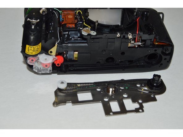

    • Remove the eight 4.8mm screws holding on the metal plate.
    • Remove the metal plate.

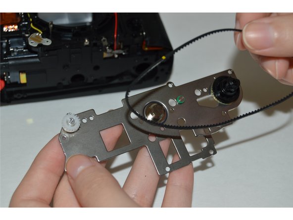

  4. Nikon N80 Gear Belt for Film Winding Replacement: crwdns2935265:04crwdnd2935265:01crwdnd2935265:02crwdne2935265:0 Nikon N80 Gear Belt for Film Winding Replacement: crwdns2935265:04crwdnd2935265:02crwdnd2935265:02crwdne2935265:0
    • Gently remove the black, rubber gear belt.
    • Discard the old belt responsibly.
    • Place new belt on.
