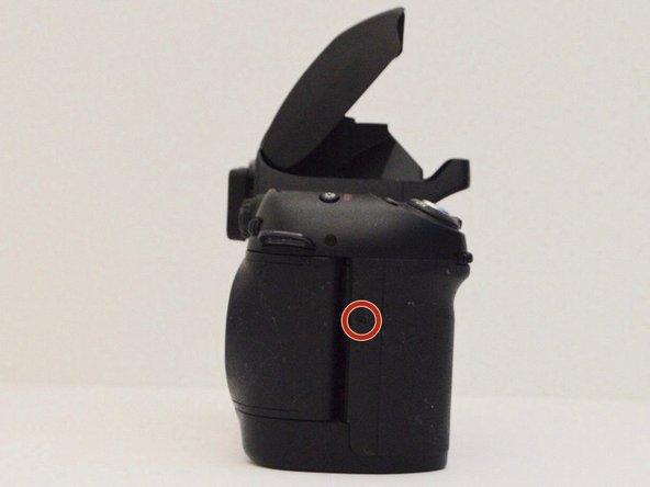

  2. Nikon N80 Film Door Replacement: crwdns2935265:02crwdnd2935265:01crwdnd2935265:03crwdne2935265:0 Nikon N80 Film Door Replacement: crwdns2935265:02crwdnd2935265:02crwdnd2935265:03crwdne2935265:0 Nikon N80 Film Door Replacement: crwdns2935265:02crwdnd2935265:03crwdnd2935265:03crwdne2935265:0
    • Remove the four 4.8mm screws on the top section of the camera using a PH00 Phillips screwdriver.
    • Two of the screws are located by the viewfinder and and the other two are on each side of the camera.

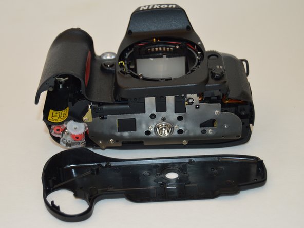

    • Rotate the camera so the bottom plate is accessible.
    • Remove the seven 4.8mm screws on the bottom plate of the camera using a PH00 Phillips screwdriver.
    • Remove the two 4.8mm screws on the bottom plate of the camera using a PH00 Phillips screwdriver.
    • Remove the bottom plate.

It's unnecessary to disassemble the camera to this extent. You just need to disconnect the ribbon cable (which involves removing the spring loaded guide next to the door hinge and unlatch the connector underneath) and unscrew the door pivot screw on the underside of the camera. This document lays it out quite nicely:
https://www.jeremymuddphoto.com/blog/202...
