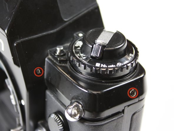

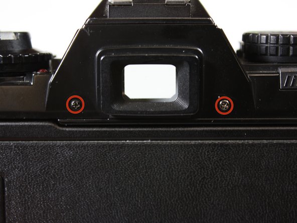

  5. Nikon N2000 (F301) Communication Board Replacement: crwdns2935265:05crwdnd2935265:01crwdnd2935265:03crwdne2935265:0 Nikon N2000 (F301) Communication Board Replacement: crwdns2935265:05crwdnd2935265:02crwdnd2935265:03crwdne2935265:0 Nikon N2000 (F301) Communication Board Replacement: crwdns2935265:05crwdnd2935265:03crwdnd2935265:03crwdne2935265:0
    • Use 00 Phillips head screwdriver to remove the screws from the top case (6 in all).

Doesn't work for the 301, although it looks similar I can't find any way to remove the top or the front case
John Chapple - crwdns2934203:0crwdne2934203:0
The F301 and N2000 are identical, so the guide should work. In this guide the top case isn't removed, as the film rewind knob is preventing it from coming off completely, and instead just lifted with the bit of leeway the popped up rewind knob provides.
Miles Kosik -
Is there a way to remove the plasticzek top cover, as comment above says, the knobs prevents me from removing this part. My plastic cover is broken and I want to change it for a new one, is there a way?
