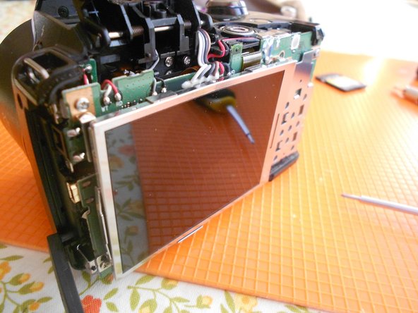

    • Now, you can separate the rear plastic frame, carefully.
    • As you can see, the entire plastic frame cames out.
    • And here it is, the display!

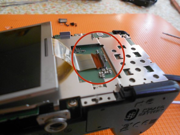

    • Lift carefully the LCD module, and you will see that is connected by a FPC connector.
    • Release the tab, and unplug the flex cable.

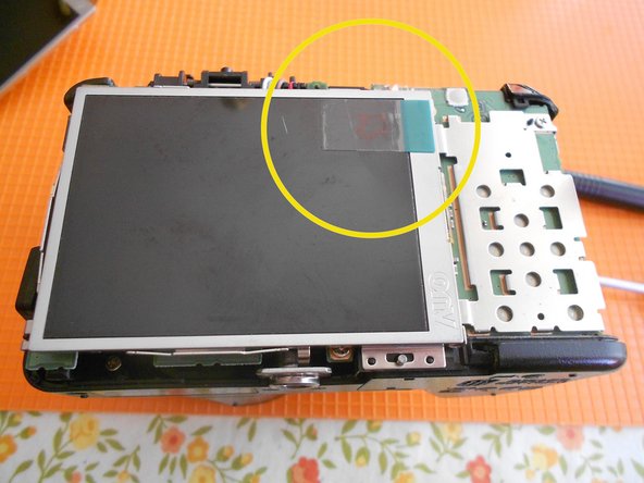

    • Insert the new flex cable and install the LCD on its frame.
    • DONT forget to remove the protective film from the NEW LCD!!
