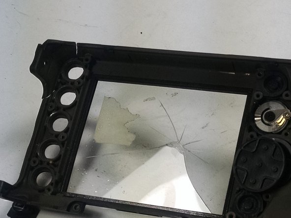

    2. Nikon D90 Rear Display Buttons Replacement, Removing the Rear Casing: crwdns2935265:02crwdnd2935265:01crwdnd2935265:03crwdne2935265:0 Nikon D90 Rear Display Buttons Replacement, Removing the Rear Casing: crwdns2935265:02crwdnd2935265:02crwdnd2935265:03crwdne2935265:0 Nikon D90 Rear Display Buttons Replacement, Removing the Rear Casing: crwdns2935265:02crwdnd2935265:03crwdnd2935265:03crwdne2935265:0
      • Use a plastic opening tool to separate the rear case from the camera.

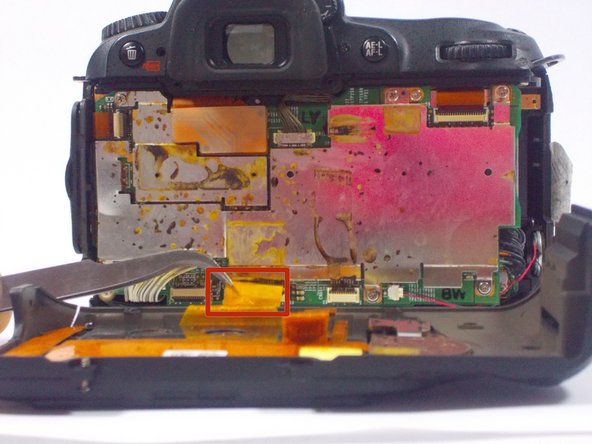

    3. Nikon D90 Rear Display Buttons Replacement, Disconnecting the Ribbon Cables: crwdns2935265:03crwdnd2935265:01crwdnd2935265:02crwdne2935265:0 Nikon D90 Rear Display Buttons Replacement, Disconnecting the Ribbon Cables: crwdns2935265:03crwdnd2935265:02crwdnd2935265:02crwdne2935265:0
      • After, remove the two orange ribbon connectors attached to the interior of the camera with tweezers.
      • Make sure to remove the ribbon cables carefully from the connectors to avoid damaging the camera.

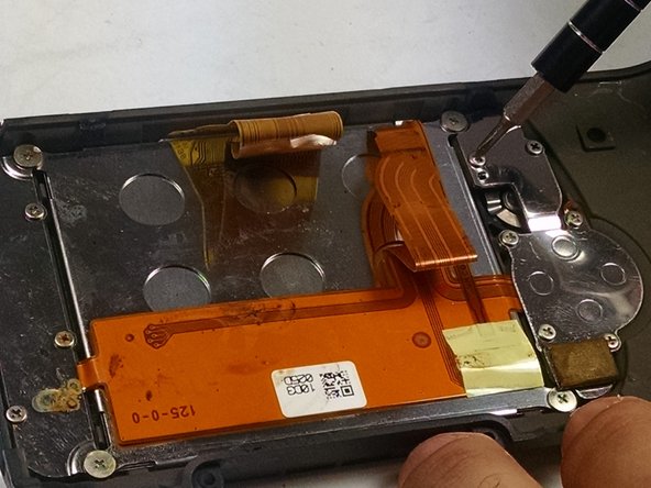

    4. Nikon D90 Rear Display Buttons Replacement, Removing the Screws from the Rear Casing: crwdns2935265:04crwdnd2935265:01crwdnd2935265:02crwdne2935265:0 Nikon D90 Rear Display Buttons Replacement, Removing the Screws from the Rear Casing: crwdns2935265:04crwdnd2935265:02crwdnd2935265:02crwdne2935265:0
      • Remove the screws from the back assembly with a Phillips (PH00) head screwdriver.
      • Remove the ten 5.3 mm Phillips screws.
      • Remove the three 4.3 mm Phillips screws.

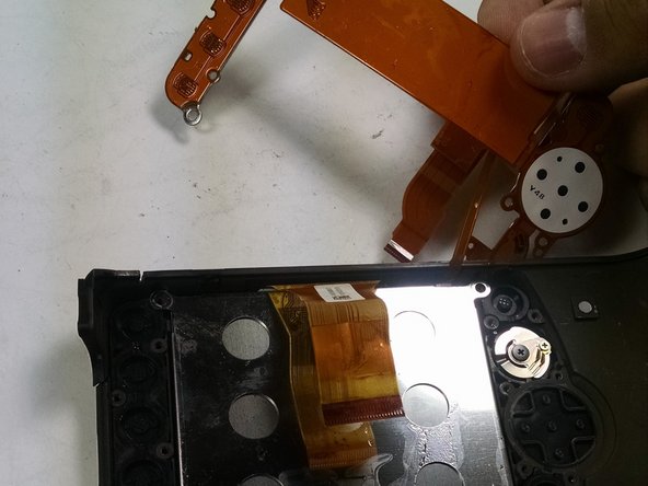

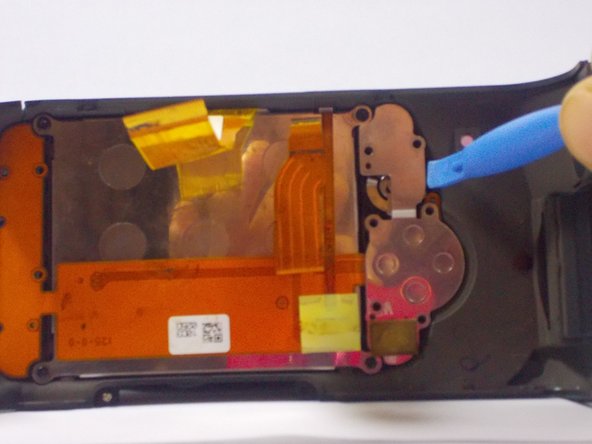

    5. Nikon D90 Rear Display Buttons Replacement, Removing the LCD and other components: crwdns2935265:05crwdnd2935265:01crwdnd2935265:03crwdne2935265:0 Nikon D90 Rear Display Buttons Replacement, Removing the LCD and other components: crwdns2935265:05crwdnd2935265:02crwdnd2935265:03crwdne2935265:0 Nikon D90 Rear Display Buttons Replacement, Removing the LCD and other components: crwdns2935265:05crwdnd2935265:03crwdnd2935265:03crwdne2935265:0
      • Use a plastic opening tool to separate the LCD and metal plates from the casing.

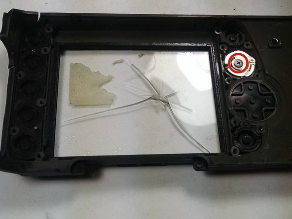

    6. Nikon D90 Rear Display Buttons Replacement, Removing the Display Buttons: crwdns2935265:06crwdnd2935265:01crwdnd2935265:03crwdne2935265:0 Nikon D90 Rear Display Buttons Replacement, Removing the Display Buttons: crwdns2935265:06crwdnd2935265:02crwdnd2935265:03crwdne2935265:0 Nikon D90 Rear Display Buttons Replacement, Removing the Display Buttons: crwdns2935265:06crwdnd2935265:03crwdnd2935265:03crwdne2935265:0
      • Use a plastic opening tool to separate the buttons from the casing.
      • Remove the 4.3 mm Phillips screw from the knob using a PH00 screwdriver.
