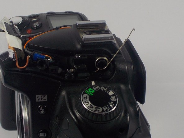

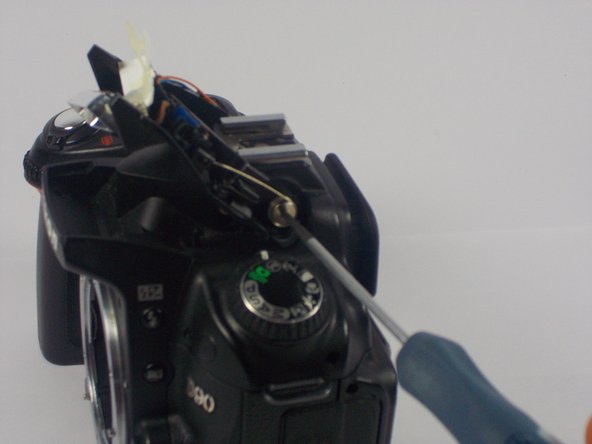

  4. Nikon D90 Flash Hinge Spring Replacement, Loosening the Spring Screw: crwdns2935265:04crwdnd2935265:01crwdnd2935265:02crwdne2935265:0 Nikon D90 Flash Hinge Spring Replacement, Loosening the Spring Screw: crwdns2935265:04crwdnd2935265:02crwdnd2935265:02crwdne2935265:0
    • Using a PH00 screwdriver, loosen the 3.3 mm Phillips screw from the spring.

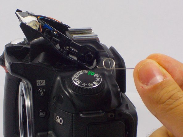

  5. Nikon D90 Flash Hinge Spring Replacement, Releasing the Spring: crwdns2935265:05crwdnd2935265:01crwdnd2935265:02crwdne2935265:0 Nikon D90 Flash Hinge Spring Replacement, Releasing the Spring: crwdns2935265:05crwdnd2935265:02crwdnd2935265:02crwdne2935265:0
    • Use a plastic opening tool and carefully pry up the spring arm.
    • Doing this with release the pressure of the spring.
  6. Nikon D90 Flash Hinge Spring Replacement, Removing the Spring: crwdns2935265:06crwdnd2935265:01crwdnd2935265:02crwdne2935265:0 Nikon D90 Flash Hinge Spring Replacement, Removing the Spring: crwdns2935265:06crwdnd2935265:02crwdnd2935265:02crwdne2935265:0
    • Finish removing the screw holding the spring in place.
    • The spring can now be removed and replaced.
