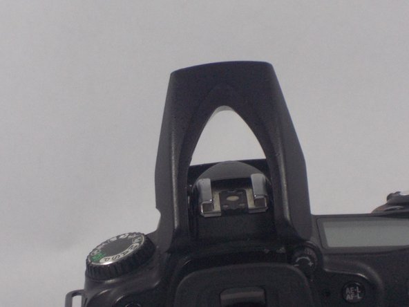

    1. Nikon D90 Flash Bulb Replacement, Open the Flash: crwdns2935265:01crwdnd2935265:01crwdnd2935265:03crwdne2935265:0 Nikon D90 Flash Bulb Replacement, Open the Flash: crwdns2935265:01crwdnd2935265:02crwdnd2935265:03crwdne2935265:0 Nikon D90 Flash Bulb Replacement, Open the Flash: crwdns2935265:01crwdnd2935265:03crwdnd2935265:03crwdne2935265:0
      • Use a plastic opening tool to lift up the flash.

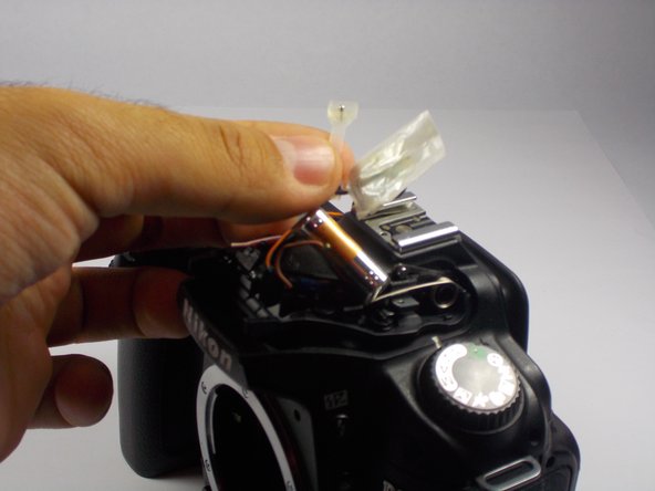

    1. Nikon D90 Flash Bulb Replacement, Removing the Bulb Tape: crwdns2935265:04crwdnd2935265:01crwdnd2935265:02crwdne2935265:0 Nikon D90 Flash Bulb Replacement, Removing the Bulb Tape: crwdns2935265:04crwdnd2935265:02crwdnd2935265:02crwdne2935265:0
      • Carefully unclip the bulb casing from the plastic casing using tweezers.
      • Remove the black and white tape on the bulb casing.
      • This tape is what holds the wires and bulb in place.
    2. Nikon D90 Flash Bulb Replacement, Removing the Bulb: crwdns2935265:05crwdnd2935265:01crwdnd2935265:03crwdne2935265:0 Nikon D90 Flash Bulb Replacement, Removing the Bulb: crwdns2935265:05crwdnd2935265:02crwdnd2935265:03crwdne2935265:0 Nikon D90 Flash Bulb Replacement, Removing the Bulb: crwdns2935265:05crwdnd2935265:03crwdnd2935265:03crwdne2935265:0
      • Remove the rubber stopper on the left and right side of the bulb.
      • Separate the rubber stopper from the white and black tape.
      • The bulb can now be slid out and replaced.
      • Be careful not to break the bulb or cut yourself on the broken bulb.
