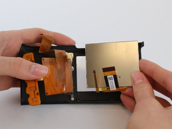

Potential damage could occur to the rear LCD screen which could affect performance. For safety purposes, please remove the battery before working with any electronic components.
    1. Nikon D80 Rear LCD Screen Replacement, Rear LCD Screen: crwdns2935265:01crwdnd2935265:01crwdnd2935265:03crwdne2935265:0 Nikon D80 Rear LCD Screen Replacement, Rear LCD Screen: crwdns2935265:01crwdnd2935265:02crwdnd2935265:03crwdne2935265:0 Nikon D80 Rear LCD Screen Replacement, Rear LCD Screen: crwdns2935265:01crwdnd2935265:03crwdnd2935265:03crwdne2935265:0
      • Using a Philips #00 screwdriver, remove the four 6.2mm from the left and right sides of the outer cover.
    2. Nikon D80 Rear LCD Screen Replacement: crwdns2935265:02crwdnd2935265:01crwdnd2935265:03crwdne2935265:0 Nikon D80 Rear LCD Screen Replacement: crwdns2935265:02crwdnd2935265:02crwdnd2935265:03crwdne2935265:0 Nikon D80 Rear LCD Screen Replacement: crwdns2935265:02crwdnd2935265:03crwdnd2935265:03crwdne2935265:0
      • Use tweezers to gently flip the small locking flap of the zero force insertion connector up.
      • Pull the orange connector cable away from the main body of the camera using the tweezers.
      • Remove the back cover.
    3. Nikon D80 Rear LCD Screen Replacement: crwdns2935265:03crwdnd2935265:01crwdnd2935265:02crwdne2935265:0 Nikon D80 Rear LCD Screen Replacement: crwdns2935265:03crwdnd2935265:02crwdnd2935265:02crwdne2935265:0
      • Using a Philips #00 screwdriver, remove the three 4.3 mm screws by rotating screwdriver to the left.
      • Use the Phillips #00 screwdriver to remove the two 3.4 mm screws.
    4. Nikon D80 Rear LCD Screen Replacement: crwdns2935265:04crwdnd2935265:01crwdnd2935265:02crwdne2935265:0 Nikon D80 Rear LCD Screen Replacement: crwdns2935265:04crwdnd2935265:02crwdnd2935265:02crwdne2935265:0
      • Using blunt tweezers, gently flip the small locking flap of the zero force insertion connector up for both connectors.
      • Use blunt tweezers to pull the left ribbon connector out of the zero insertion force connector.
      • Using the same tweezers, pull the right ribbon connector out of the zero insertion force connector.
    5. Nikon D80 Rear LCD Screen Replacement: crwdns2935265:05crwdnd2935265:01crwdnd2935265:02crwdne2935265:0 Nikon D80 Rear LCD Screen Replacement: crwdns2935265:05crwdnd2935265:02crwdnd2935265:02crwdne2935265:0
      • Slide out the LCD screen by pulling towards the right.
      • Remove the LCD screen.
      • The buttons beside the screen fall out easily. Remember where they were and put them back when finished with the screen.
