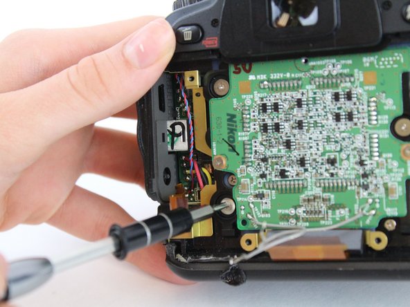

    4. Nikon D80 Motherboard Replacement: crwdns2935265:04crwdnd2935265:01crwdnd2935265:02crwdne2935265:0 Nikon D80 Motherboard Replacement: crwdns2935265:04crwdnd2935265:02crwdnd2935265:02crwdne2935265:0
      • Use a Phillips #00 screwdriver to unscrew the 2.3 mm screw.
    5. Nikon D80 Motherboard Replacement: crwdns2935265:05crwdnd2935265:01crwdnd2935265:01crwdne2935265:0
      • Use tweezers to gently flip the small locking flaps of the zero force insertion connectors up.
      • Pull the bottom orange connector cable out of the zero force insertion connector using the tweezers.
      • Pull the top orange connector cable out of the zero force insertion connector using the tweezers.
      • Remove the ribbon cables by gently pulling them away from the no-fuss ribbon cable connectors.
      • Disconnect the main board from the two ports on the left by pulling the main board to the right.

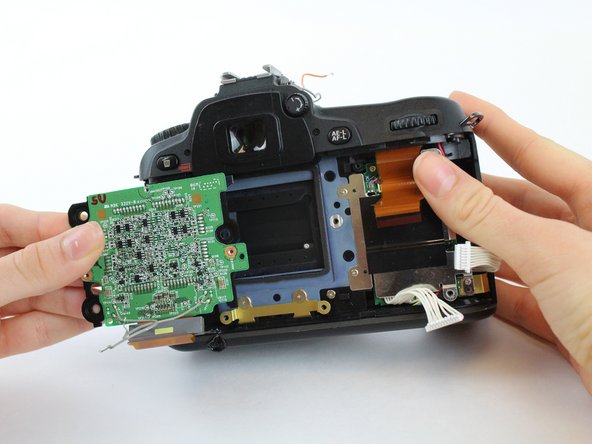

    6. Nikon D80 Motherboard Replacement: crwdns2935265:06crwdnd2935265:01crwdnd2935265:03crwdne2935265:0 Nikon D80 Motherboard Replacement: crwdns2935265:06crwdnd2935265:02crwdnd2935265:03crwdne2935265:0 Nikon D80 Motherboard Replacement: crwdns2935265:06crwdnd2935265:03crwdnd2935265:03crwdne2935265:0
      • Using the soldering iron, disconnect the four wires soldered to the main board.
      • For more information on how to solder and desolder connections, please visit this guide.
      • Be careful when using the hot soldering iron. Move the ribbon cable out of the way as well; it is easy to burn it or yourself when using the iron.
      • Remove the main board.
