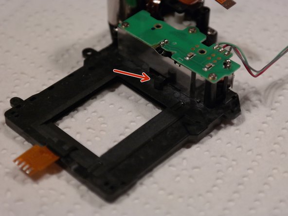

  6. Nikon D7000 Shutter Replacement: crwdns2935265:06crwdnd2935265:01crwdnd2935265:03crwdne2935265:0 Nikon D7000 Shutter Replacement: crwdns2935265:06crwdnd2935265:02crwdnd2935265:03crwdne2935265:0 Nikon D7000 Shutter Replacement: crwdns2935265:06crwdnd2935265:03crwdnd2935265:03crwdne2935265:0
    • Turn the gears to open the curtain.
    • The lever is then right.
    • When assembling, press the shutter lever down.
Repeat the steps in order to reassemble your device.

Does not work shutter with this steps, gives shutter error.
farman G - crwdns2934203:0crwdne2934203:0
does not work with this last step. gives shutter error. while shutter been taking of from assembly unit, it seems no way to get back it work with new shutter unit.
