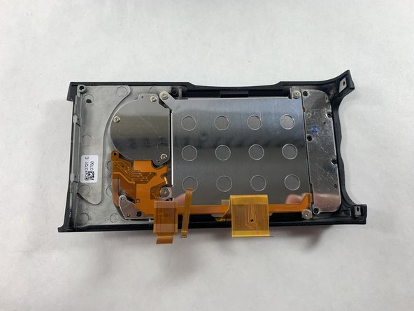

      • Use a spudger and your hands to remove the front grip cover, held together by an adhesive.
      • You may need to use heat to loosen up the adhesive. Try using the iOpener.
      • Under the rubber cover, use a screwdriver to remove one screw on the top right corner.
    2. Nikon D700 Screen Replacement: crwdns2935265:02crwdnd2935265:01crwdnd2935265:02crwdne2935265:0 Nikon D700 Screen Replacement: crwdns2935265:02crwdnd2935265:02crwdnd2935265:02crwdne2935265:0
      • Use a Phillips #00 screwdriver to remove the five screws that hold the cover in place.
    3. Nikon D700 Screen Replacement: crwdns2935265:03crwdnd2935265:01crwdnd2935265:01crwdne2935265:0
      • Gently remove the screen by pulling the top away from the body.
      • The screen is connected by wires on the bottom, so be careful when taking the screen off.

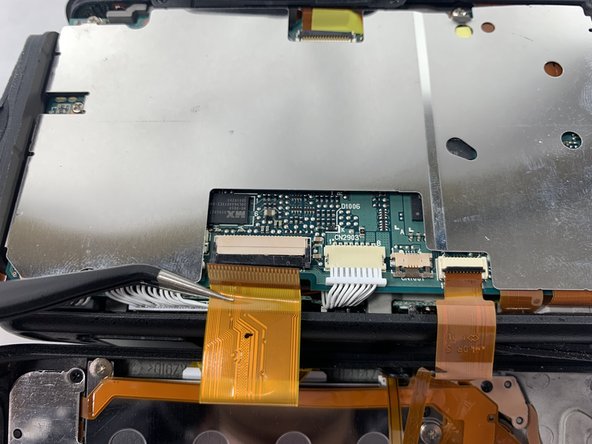

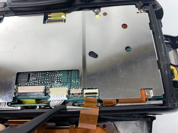

    4. Nikon D700 Screen Replacement: crwdns2935265:04crwdnd2935265:01crwdnd2935265:03crwdne2935265:0 Nikon D700 Screen Replacement: crwdns2935265:04crwdnd2935265:02crwdnd2935265:03crwdne2935265:0 Nikon D700 Screen Replacement: crwdns2935265:04crwdnd2935265:03crwdnd2935265:03crwdne2935265:0
      • To remove the screen entirely, use a spudger to unlock the connectors.
      • Pull the cables out gently using tweezers or your spudger.
    5. Nikon D700 Screen Replacement: crwdns2935265:05crwdnd2935265:01crwdnd2935265:02crwdne2935265:0 Nikon D700 Screen Replacement: crwdns2935265:05crwdnd2935265:02crwdnd2935265:02crwdne2935265:0
      • The screen should be completely detached from the camera and can now be replaced with a new screen.
