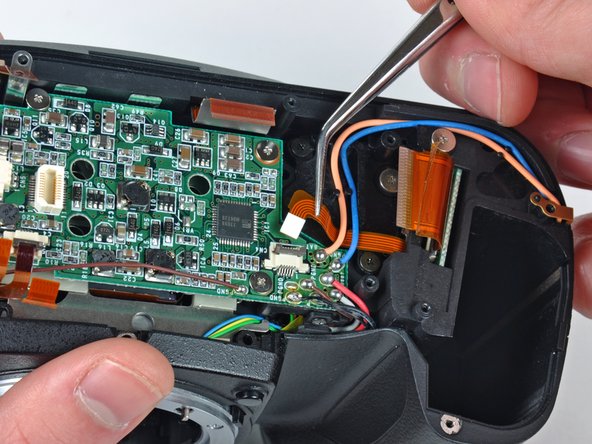

  16. Nikon D70 DC/DC Board Replacement: crwdns2935265:016crwdnd2935265:01crwdnd2935265:01crwdne2935265:0
    • Carefully de-solder the eight leads boxed in red.
    • Do not heat up the board excessively while de-soldering. There are many heat sensitive components mounted to the DC/DC board.
    • There are two black leads that look very similar. The thinner of the two connects closer to the center of the board.
