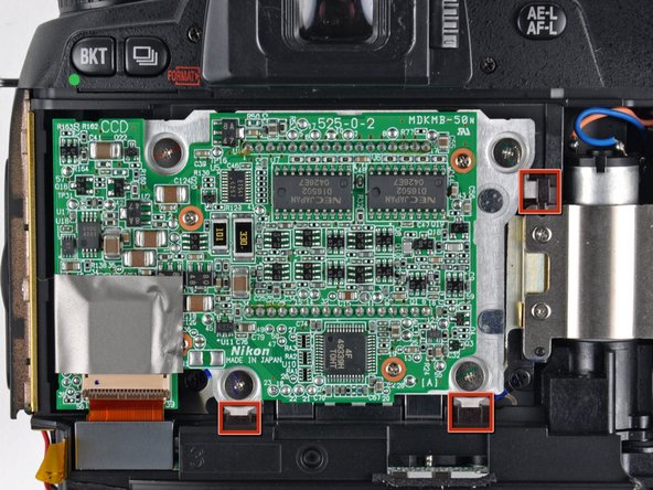

    1. Nikon D70 CCD Board Replacement, CCD Board: crwdns2935265:012crwdnd2935265:01crwdnd2935265:02crwdne2935265:0 Nikon D70 CCD Board Replacement, CCD Board: crwdns2935265:012crwdnd2935265:02crwdnd2935265:02crwdne2935265:0
      • De-route the two leads routed over the connector boxed in yellow.
      • Use your thumbnails to push the connector out of its socket.
    2. Nikon D70 CCD Board Replacement: crwdns2935265:013crwdnd2935265:01crwdnd2935265:01crwdne2935265:0
      • Remove the two Phillips screws securing the grip side of the rear cover to the D70.
    3. Nikon D70 CCD Board Replacement: crwdns2935265:014crwdnd2935265:01crwdnd2935265:01crwdne2935265:0
      • Remove the two Phillips screws securing the DC-In side of the rear cover to the D70.
    4. Nikon D70 CCD Board Replacement: crwdns2935265:015crwdnd2935265:01crwdnd2935265:02crwdne2935265:0 Nikon D70 CCD Board Replacement: crwdns2935265:015crwdnd2935265:02crwdnd2935265:02crwdne2935265:0
      • Carefully pull the sides of the rear cover away from the body of the D70.
      • Pull the rear cover off the body of the D70, minding the LCD board ribbon cable that may get caught.
    5. Nikon D70 CCD Board Replacement: crwdns2935265:016crwdnd2935265:01crwdnd2935265:01crwdne2935265:0
      • At this point, the capacitor is visible and its exposed contacts are boxed in red. Even though they are recessed, be careful not to touch the contacts to avoid shocking yourself.
    6. Nikon D70 CCD Board Replacement: crwdns2935265:017crwdnd2935265:01crwdnd2935265:01crwdne2935265:0
      • Peel back the piece of tape connecting the iron core around the CCD board ribbon cable to the inner case.
    7. Nikon D70 CCD Board Replacement: crwdns2935265:018crwdnd2935265:01crwdnd2935265:01crwdne2935265:0
      • Remove the four 4.8 mm Phillips screws securing the CCD board to the D70.
    8. Nikon D70 CCD Board Replacement: crwdns2935265:019crwdnd2935265:01crwdnd2935265:02crwdne2935265:0 Nikon D70 CCD Board Replacement: crwdns2935265:019crwdnd2935265:02crwdnd2935265:02crwdne2935265:0
      • Remove the CCD board from the D70, minding any cables that may get caught.
      • When reinstalling the CCD board, be sure to press the alignment posts on the right and bottom edges of the board up against the guides machined into the case while tightening the screws down.

Great instructions.
One important note: When re-installing the CCD board ribbon cable into the CCD board, the cable will go into the connector about 2mm and feel like it's seated. However, the cable must go 3mm-4mm into the connector. Otherwise, you will get a "This Card Cannot Be Used" error message each time you depress the shutter button.
